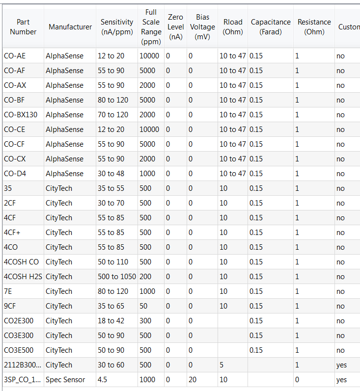

GASSENSOREVM: which sensors from alphasense work with this board?
Part Number: GASSENSOREVM
hello
i was reading over the design files and requirements for this board. it states that it supports the O2 sensor: Alphasense A2 series and CO sensor: Alphasense CO-AF series. My question is, does it only support these two or can it support any others? If so, which others can it support? Is there a product line or reference to these sensors?
I have been looking on alphasense.com but I have not found any clues yet.
can anyone please point me in the right direction?
