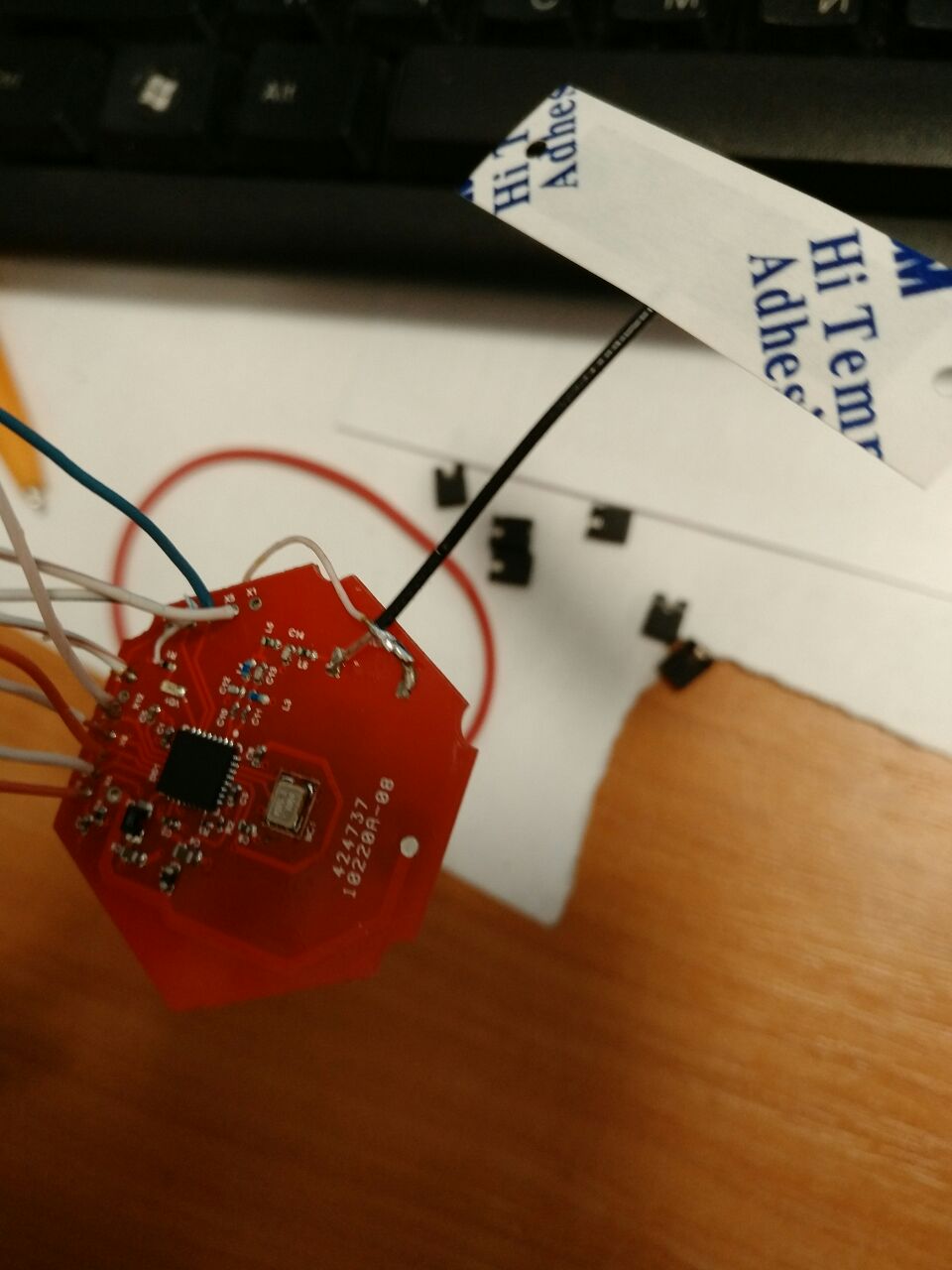

Hello
We made Beacon design based on SensorTag 2 design.
We just change antenna to chip and add some interfaces (UART fot bootloader).
We got very strange behavior showing in 2 aspects:
  1. no activity on UART pins in bootloader
  2. no RF activity at all
We can access SoC through JTAG (program flash, start debug). But nothing happens more.
It's very strange, because in our first revision of PCB RF working good (so firmware is correct). We just replace inverted-F antenna to chip ALA621C4
It's need to be pointed, that boot loader hasn't working on first PCB revision too. When we connect external SoC to launchpad Rx/Tx and launchpad power we don't see anything. When SoC on Launchpad in the same conditions are booting properly.
Can TI check our design (see attachment bellow) and give us some advice about this situation?
Beacon.pdf
