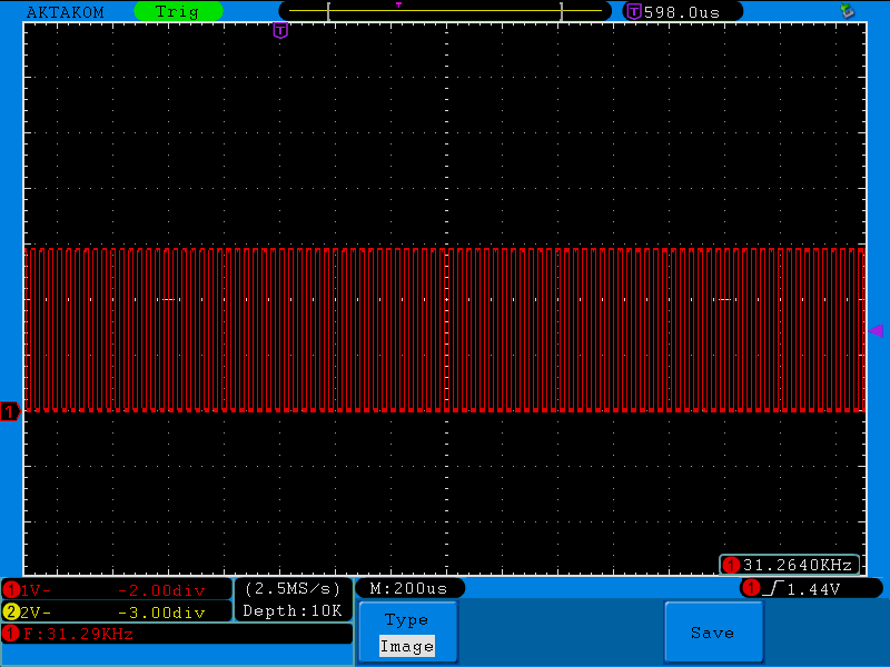

  • Hi JXS,
    Your suggestion about the RF frontend was actually the first thing I looked into. My custom board uses a differential frontend with external bias, and the package is the 5XD variant of the CC2640R2, and the proper symbols are defined in the project for this configuration.
    Thanks for the suggestion on the compiler version, and for pointing out that BTool has better documentation now. I couldn't find it when I had looked previously. I'll look further into this tonight, and will post details about whatever I find out.
    Thanks again,
    -Ben
