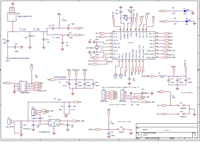

Dear Sir,
i design a circuit based on cc2650 with the reference cc2650 LAUNCHXL and SENSOR TAG SCHEMATIC.
after all i try to dump the one of the Bluetooth stack to cc2650 by using xds110 debugger .
the problem is i can not dump the code to cc2650.  i used 3v coin cell battery for this when connect the cell it consumes 5-6mA of current .
here i want to test cc2650 port line toggle to turn ON/OFF the LED..if i did complete that exercise i can write my own code.
below shows the schematic and and component placement.

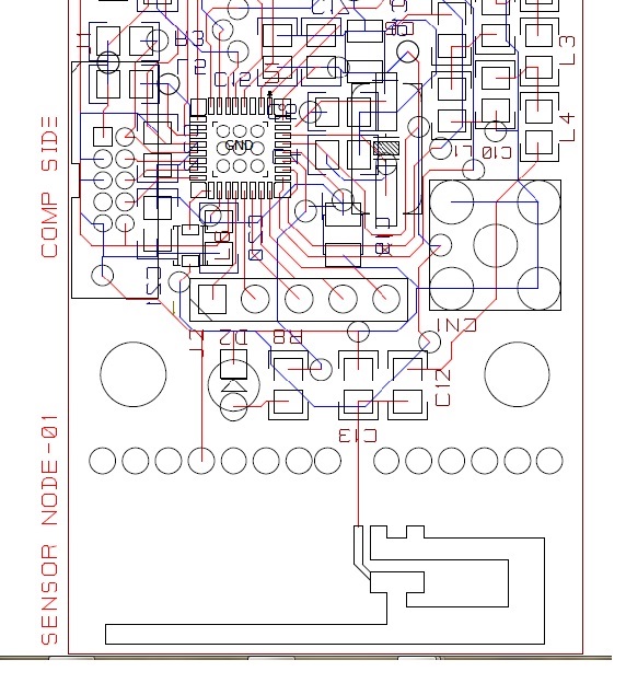

below shows the cc2650 base placement .. i used both  32KHz and 24MHz creystalls
