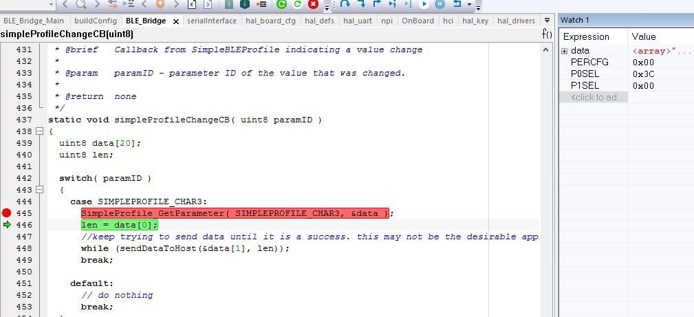

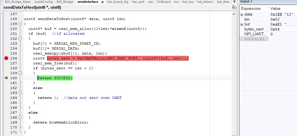

I'm using the BLE 1.4.2 SDK with a CC2540. The board file used for every project in the SDK (hal_board_cfg.h) is configured for UART 1 Alt. 2 in SPI mode.
Can anyone point me to a board file configured for USART0 Alt. 2 in UART mode? Or explain to me how I can change the existing board configuration?
