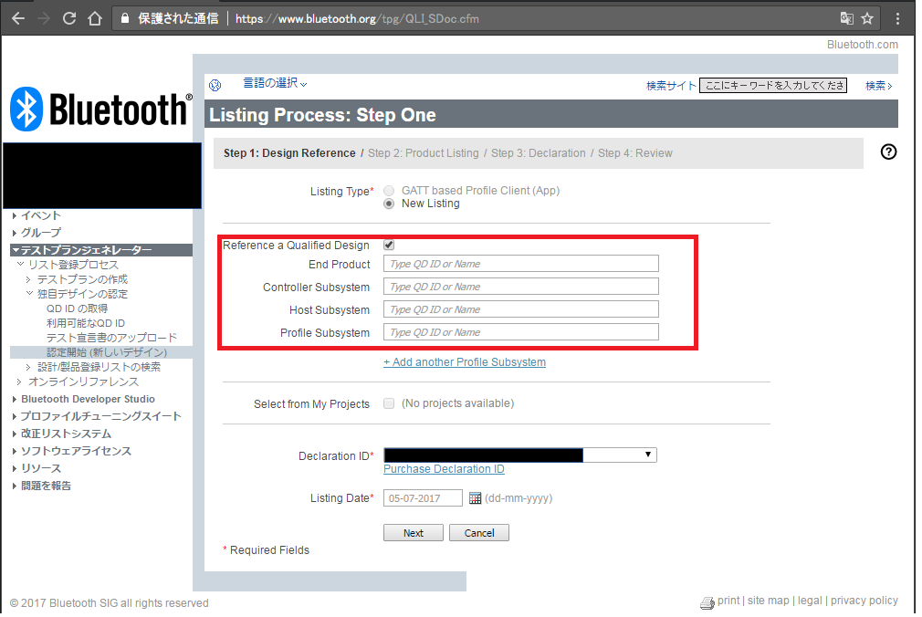

My customer is trying to register EPL using CC2650MODA.
The QDID of CC2650MODA is registered with Component,
In the screen below Component is not displayed.
I would like to use QDID below.
  CC 2650 MODA : 88415
  BLE-Stack 2.2.x-3.x : 82185
How can I apply it?
hamada
  • Hello hamada,
    It looks like SIG has changed the front end process slightly. From the SIG qual page: www.bluetooth.com/.../qualification-listing , select the first option for "Modifying an existing Bluetooth design in any way". This will allow you to create a new listing by "Reference a Qualified Traditional Project" using the stack QDID 82185. Remember to change the product type to "End Product." From there you can create the project and then combine with the CC2650MODA's RF-PHY QDID 88415.
