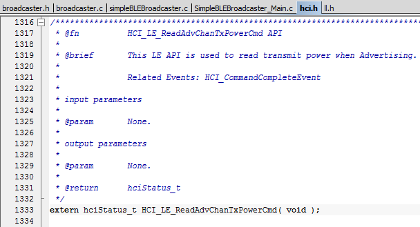

I would like to use SimpleBLEBroadcaster project and read Tx power level.
I have found some post that we can use "HCI_LE_ReadAdvChanTxPowerCmd" to achieve it.
However, I could not find any function of "HCI_LE_ReadAdvChanTxPowerCmd" except from header file declaration below.

    1.
    The output power is set to 0 dBm by default after init and will remain the same until you change it with HCI_EXT_SetTxPowerCmd.
    HCI_LE_ReadAdvChanTxPowerCmd will send an command complete event (HCI_LE_READ_ADV_CHANNEL_TX_POWER) with the output power given as the second argument in the returned message. You can handle this in SimpleBLEBroadcaster_ProcessEvent.

    No,
    basically you should not have to worry about this as the programmed output power should remain the same.
    The HCI_LE_ReadAdvChanTxPowerCmd will send an command complete event  to the host. This message is received in the profile implementation GAPRole_ProcessEvent() in broadcaster.c and handled in gapRole_ProcessOSALMsg(). This is currently not implemented for the HCI_LE_READ_ADV_CHANNEL_TX_POWER, but as a reference it is implemented for HCI_READ_RSSI in the peripheral example. If you like you can add handling for the HCI_LE_READ_ADV_CHANNEL_TX_POWER and add a callback function in pGapRoles_AppCGs (type gapRolesCBs_t) to get a callback in your application.
    static void gapRole_ProcessOSALMsg( osal_event_hdr_t *pMsg )
      switch ( pMsg->event )
        case HCI_GAP_EVENT_EVENT:
    ... you would need to add a case for HCI_LE_READ_ADV_CHANNEL_TX_POWER here......
    The second byte in the return value ( pPkt->pReturnParam[1]) then correspond to the output power in the format seen below.
