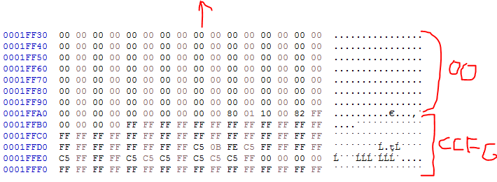

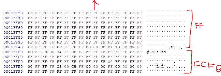

  • Hello, @
    Thanks for fast reply and useful information. Still, I am not able to program my device right... Let me explain my situation more briefly:
    First things first, how do I generate .bin file? (the project I am using is official project from TI: project_zero_cc2640r2lp_app)
    Well I have two ways of doing it:
    1. CCS studio supports this out of the box with the post build command:
    "${CCS_INSTALL_ROOT}/utils/tiobj2bin/tiobj2bin" "${BuildArtifactFileName}" "${BuildArtifactFileBaseName}.bin" "${CG_TOOL_ROOT}/bin/armofd" "${CG_TOOL_ROOT}/bin/armhex" "${CCS_INSTALL_ROOT}/utils/tiobj2bin/mkhex4bin"
    2. With the hex2bin.exe tool.
    Both files are successfully generated, but are different (wow - see the HASH below).
    The first .bin file, generated via CCS studio - base64: /0bHwLfyi12Mt6dkY2i6NIxbP25CoKFLfUxU80whFf4=
    The second .bin file, generated via hex2bin - base64: waC0ia/PxZPvvxHmWXRgekhKrBir/OV/xSE8Z6PQ1zQ=
    At first look, there are two differences:
    1. First is the padding: hex2bin file pads the .bin file with 0xFF, the CCS converter pads it with 0x00.
    2. Second is the last sector data (or where the CCFG register lies - Sector31 on cc2640): different data
    Let me show you some pictures:
    1. First image is CCS .bin file:
    2. The second image is a hex2bin file:
    Please note the differences, I marked them with the red colour. So they are different indeed. What you might be interested in is that if I put CCS .bin file to Flash Programmer 2, programming DOES NOT WORK! If I put .bin file from hex2bin.exe programming WORK!
