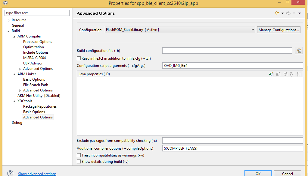

I am trying to do onchip OAD for SPP_ble client
so I imported Spp_ble_clieint_app example project and trying to generate Image B
I followed the steps in this link(http://dev.ti.com/tirex/content/simplelink_cc2640r2_sdk_1_30_00_25/docs/blestack/ble_sw_dev_guide/html/oad/oad.html#add-on-chip-oad-to-an-existing-project) to add OAD onchip(Image B) to an existing project.
I am using CCSv7.2.0 with compiler TIv15.12.6 LTS.
I am facing the following errors while compiling. here is the build log.

How can i solve this to generate on-chip OAD Image B for SPP_ble_client?
Please help me.
thanks,
Santhananarayanan

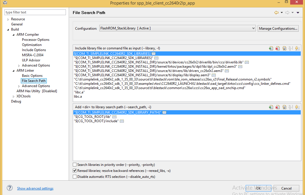

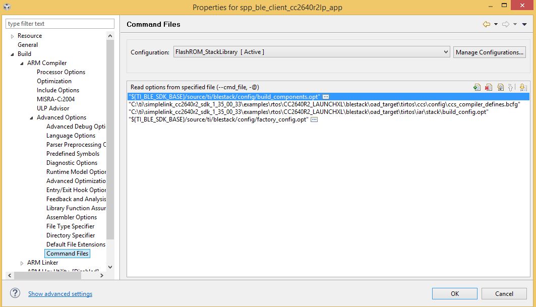

    we took the example spp_ble_client project I build it successfully and downloaded to CC2640R2_LaunchXL and it is working successfully.
    we are looking to generate spp_ble_client Image B for onChip OAD. For generating B image we applied changes as mentioned in this link (http://dev.ti.com/tirex/content/simplelink_cc2640r2_sdk_1_30_00_25/docs/blestack/ble_sw_dev_guide/html/oad/oad.html#add-on-chip-oad-to-an-existing-project)
    the following errors we are facing after we applied the changes to the spp_ble_client_cc2640r2lp_app project.

    we did change only mentioned in the guide.
    i attached the images where we changed for adding onChip OAD.
    anything others I have to change mentioned in the guide for spp_ble_client?
    Please help us.
    thanks,
    Santhananarayanan
