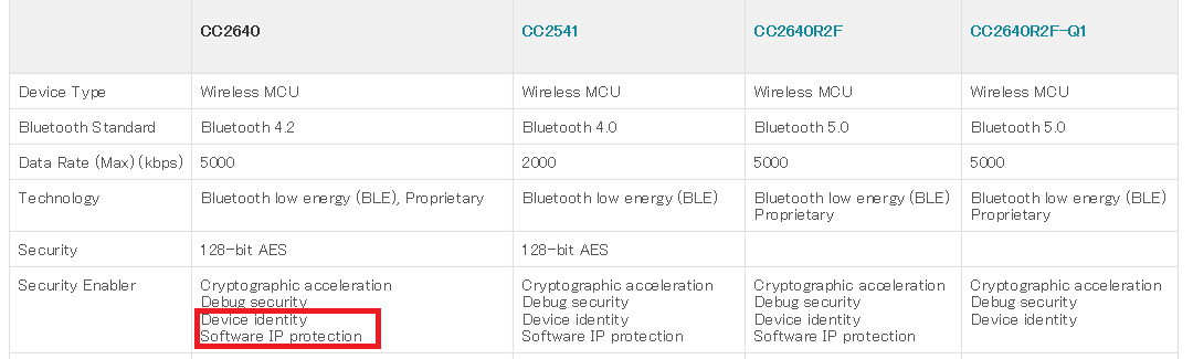

Part Number: CC2640
Please tell me about CC26xx series Secure Enabler items.
"Device identity"
"Software IP protection"
What is the function of this item?
hamada
Hello Hamada,
Excellent question! I would first direct you to our Security Portal:
where you can find a detailed definition of the individual Security Enablers. For the CC2640 & CC2640R2F Bluetooth low energy wireless MCUs, this is explained in tech doc swpb016.
As excerpted from the document:
