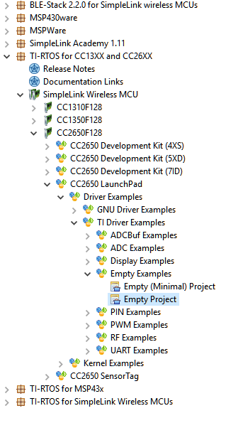

please help me to write a source code for blinking a LED in css using cc2650

you can take look at this pdf..
BLINKING AN LED:
while(TRUE)
PIN_setOutputValue(hPin,Board_LED0,IOID_10);
Task_sleep (delaybyDurationUs / Clock_tickPeriod);
PIN_setOutputValue(hPin,Board_LED0,IOID_0);
PIN_setOutputValue(hPin,Board_LED1,IOID_15);
PIN_setOutputValue(hPin,Board_LED1,IOID_0);
