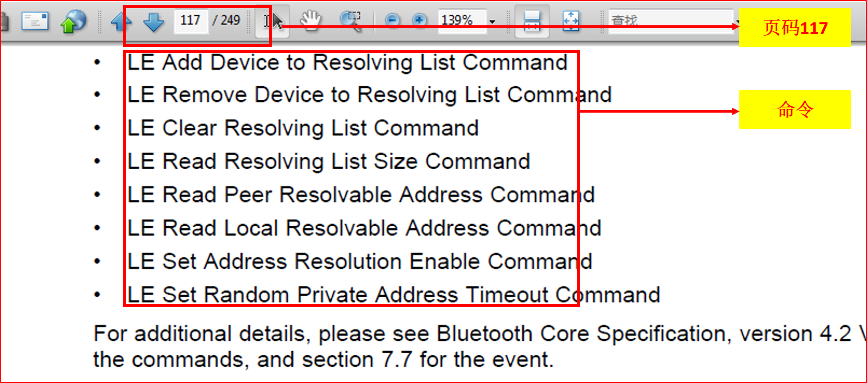

    When connecting with peer devices that use RPAs, such as all iOS and Android 6+ central devices, you must use the Resolving List and not the White List. Refer to the LE Privacy 1.2 section in the SW User Guide: software-dl.ti.com/.../gapbondmngr.html

        I have read the soft ware develop guide for several times ,however , I failded to add my iphone to the resolving list through HCI commands ,as shown in picture 1 .
        Can you just show me the code block of using the resolving list ?
