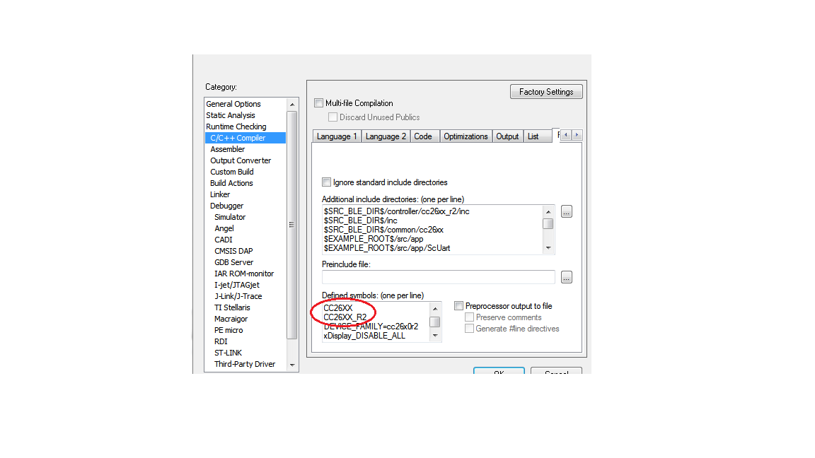

  • But, actually,
    the options(CC26XX & CC26XX_R2) are being used as default as the related macro definitions are set to the pre-processor your SDK has.
    Please guide me to integrate it well without any issues.
  • You do not have to change any of the defined symbols in the project options. You only have to do what I wrote in my first post.
    1) Change the RF configuration define in your board file to CC2650EM_4XS
    2) In ble_user_config.h change the RF pin and bias option if applicable

    Did you have CC26XX_R2 defined in your build?
  • Yes, the CC26XX_R2 is defined in the preprocessor, but CC26xx also is defined as default, so I thought that a macro derived from the CC2650EM_4IS should be used because it shows the comments with respect to single-ended & internal bias mode.
    Anyway, I will only use what Fredrik and you mentioned and pointed for me.
    Thank you so much.
    BR,
    Ji Won
  • Yes. It is a bit confusing. We need to keep both defines and CC26XX is used in the other part of the code even the build is for R2.

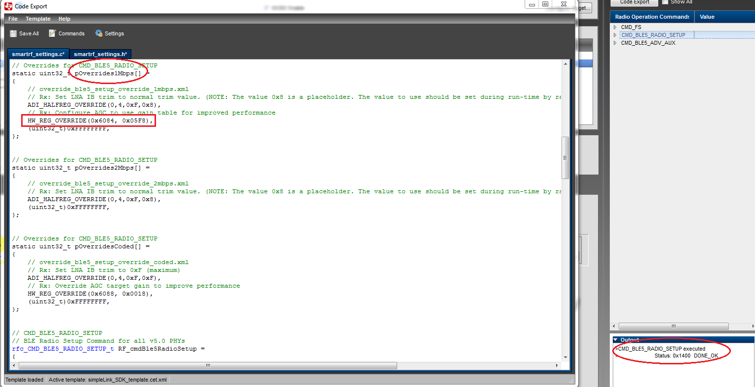

  • I found the related things from RF studio.
    And I got the status is DONE_OK when the command requested.
  • Should I copy the related commands in yellow to the related parts in ble_user_config.c ?
    // Overrides for CMD_BLE5_RADIO_SETUP
    static uint32_t pOverridesCommon[] =
        // override_ble5_setup_override_common.xml
        // Rx: Set LNA IB offset used for automatic software compensation to 0
    (uint32_t)0x00008883,
        // Rx: Set LNA IB trim value based on the selected defaultPhy.mainMode setting. (NOTE: The value 0x8 is a placeholder. The value to use should be set during run-time by radio driver function.)
    ADI_HALFREG_OVERRIDE(0,4,0xF,0x8),
        // override_frontend_is_rfp.xml
        // Rx: Set RSSI offset to adjust reported RSSI by -2 dB
    (uint32_t)0x000288A3,
    (uint32_t)0xFFFFFFFF,
    static uint32_t pOverrides1Mbps[] =
        // override_ble5_setup_override_1mbps.xml
        // Rx: Set LNA IB trim to normal trim value. (NOTE: The value 0x8 is a placeholder. The value to use should be set during run-time by radio driver function.)
        // Rx: Configure AGC to use gain table for improved performance
    HW_REG_OVERRIDE(0x6084, 0x05F8),
    static uint32_t pOverrides2Mbps[] =
        // override_ble5_setup_override_2mbps.xml
    static uint32_t pOverridesCoded[] =
        // override_ble5_setup_override_coded.xml
        // Rx: Set LNA IB trim to 0xF (maximum)
    ADI_HALFREG_OVERRIDE(0,4,0xF,0xF),
        // Rx: Override AGC target gain to improve performance
    HW_REG_OVERRIDE(0x6088, 0x0018),
    BR,
    Ji Won
  • Ji Won,
    You should just use the overrides that are already in the BLE Stack. There is no need to change these or add anything.
    Fredrik
