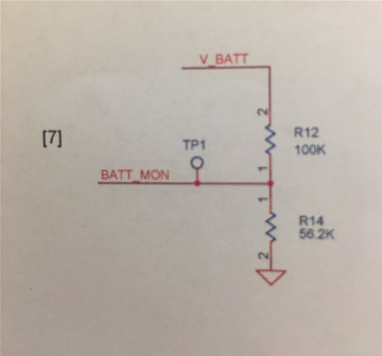

Our custom board (based on CC2640) have a BATT_MON connected to pin IO_29, its schematic is as follow,
Our board is powered by a 3.7V battery and it is running off a regulator, so it’s unable to use TI internal battery moniror AONBatMonBatteryVoltageGet. The BATT_MON is on an analog capable pin (DIO29), so I assume it would be able to read the value on that pin. We want to add this to monitor the battery voltage to save/synchronize the progress in our project. Is there any simple code snipset I could follow to achieve this (I have no experience with adc reading). What changes would I have to make in CC2650_LAUNCHXL.h, .c, Board.h to make it to work?

    Just one last question before closing this post: In the adcsinglechanel project, the program read the adc from main:
        adc = ADC_open(CC2650_LAUNCHXL_ADCVSS, &params);
        //or adc = ADC_open(CC2650_LAUNCHXL_ADCVDDS, &params);
        if (adc == NULL) {
            System_abort("Error initializing ADC channel 0\n");
        else {
            System_printf("ADC channel 0 initialized\n");
        /* Blocking mode conversion */
        res = ADC_convert(adc, &adcValue0);
    I think this code segment tries to read the ADC value from CC2650_LAUNCHXL_ADCVSS or CC2650_LAUNCHXL_ADCVDDS, these ADCs are also in enum of ADCs in CC2650_LAUNCHXL.h,
     *  @def    CC2650_LAUNCHXL_ADCName
     *  @brief  Enum of ADCs
    typedef enum CC2650_LAUNCHXL_ADCName {
        CC2650_LAUNCHXL_ADC0 = 0,
        CC2650_LAUNCHXL_ADC1,
        CC2650_LAUNCHXL_ADC2,
        CC2650_LAUNCHXL_ADC3,
        CC2650_LAUNCHXL_ADC4,
        CC2650_LAUNCHXL_ADC5,
        CC2650_LAUNCHXL_ADC6,
        CC2650_LAUNCHXL_ADC7,
        CC2650_LAUNCHXL_ADCDCOUPL,
        CC2650_LAUNCHXL_ADCCOUNT
    } CC2650_LAUNCHXL_ADCName;
    So, in my particular case, if I want to read ADC value from DIO_29, the ADC in the first code segment should be change to CC2650_LAUNCHXL_ADC6, is it correct?
    Thank you,
    Henry
  • Yes. If you want to read ADC value from DIO_29, the ADC in the first code segment should be change to CC2650_LAUNCHXL_ADC6.
