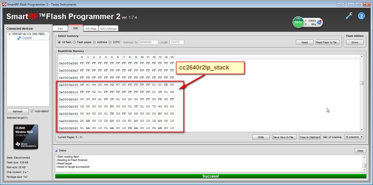

  • Hi JXS,
    Thank you for your info.
    But which configuration leads to stack in ROM?
    After download code in flash, I found that stack is flash. here is the layout:
    cc2640r2lp_bim_onchip :         0x0001 f000 - 0x0001 ffff
    cc2640r2lp_persisten_app:     0x0001 5000 - 0x0001 efff
    SNV                                                0x0001 4000 - 0x0001 4ff
    cc2640r2lp_stack                        0x0000 b000 - 0x0001 3fff
    cc2640r2lp_app                           0x0000 0000 - 0x0000 affff
    Only after  I download cc2640r2lp_stack to flash area 0x0000 b000 - 0x0001 3fff, the cc2640r2lp_persisten_app or  cc2640r2lp_app  can work.
    I don't think my added code make the issue, because my code can work well in CC2640. I just port the code form CC2640 to CC2640R2F.
    Best wishes,
    Charles
  • Hi Charles,
    By default the BLE protocol stack uses ROM for its builds, but some components are also built in flash.
    The OAD stacks are using a slightly larger build configuration than you may need.
    if you don't need service changed indications (plan to discover services every time) you can gain 8kB of flash memory (two pages) by removing the L2CAP CoC feature from the stack build configuration.
    To do this you will need to perform the following steps:
    1. in the build_config.opt file of the stack project, comment out the line: -DV41_FEATURES=L2CAP_COC_CFG
    2. In the application files (simple_peripheral_oad_onchip.c, oad_persistent_app.c) comment out references to GAPBondMgr_ServiceChangeInd( );
    3. Clean and rebuild persistent app, stack in that order.
  • Hello Sean,
    You method is great!
    Thank you very much!
