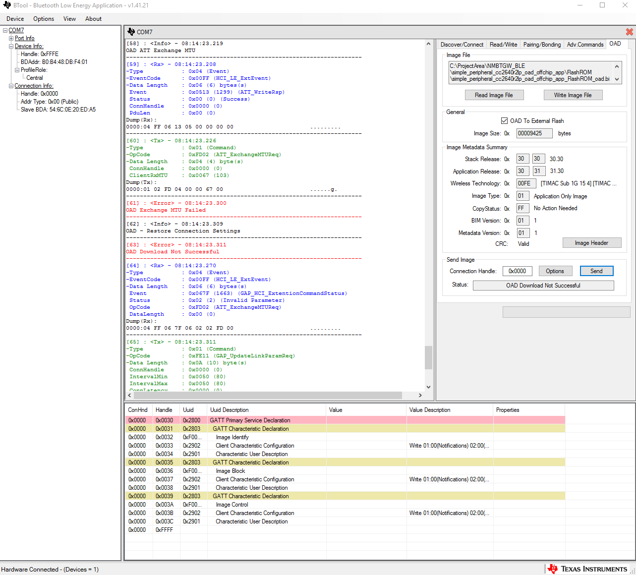

The second issue I have with the OAD example is when I try to do OAD then I get this message:
I have a hard time finding out the reason behind this failure. I have not done any modifications to the code except adaptation to my custom board. OAD worked without any problems on the same board layout but with the cc2640 processor.
  • Hi Niklas,
    For your first issue, which files are you flashing?
    For your second issue, it looks like the MTU exchange procedure fails. What are you using as your Host Test device - HW and SW version?

  • Hi Niklas,
    The OAD Downloader must support Data Length Extension procedure to work BTool. You will have to rebuild the Host Test project with -DBLE_V42_FEATURES=EXT_DATA_LEN_CFG uncommented in build_config.opt. If it doesn't fit with Data Length Extension enabled, you can change the Host Build Configurations to -DHOST_CONFIG=PERIPHERAL_CFG only.
    Please try changing that and see if you can complete a successful OAD. If you device doesn't advertise after downloading, please let me know. I think your side question is correct: I think the BIM is having trouble with the image header. Checking after performing an OAD will confirm this.

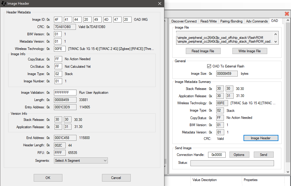

    Can you take a picture of your BTool Image Metadata Summary and Image Header Metadata? Click the Image Header button next to the CRC field in the Image Metadata Summary to see the full Header Metadata information.
  • Hi Rachel,
    The changes I made to get the custom board up and running was to define CC2650EM_7ID in CC2640R2DK_4XS.h and added the specific Pins in board.h for my LED and two SPI channels.
    Here is an image of the Metadata.
    Niklas
  • Hi Niklas,
    I noticed that you're using a custom board and external flash OAD. Can you tell me more about your external flash part? Is it the exact same one used by the CC2640R2_LAUNCHXL? Specifically does your external flash use the same flash page size as the one on the LaunchPad (i.e. 4kB page).
    The CRC function has some slight dependencies on HAL_FLASH_PAGE_SIZE for better or for worse.
    Edit: Does the example work on the launchpad?  Also if you use jumper wires to connect your custom board to the external flash on the LaunchPad, does it work?

  • Hi Niklas,
    Thanks for the update, looking at the datasheet of your part, it appears that the flash layout may be a little different than the one on the launchpad.
    It appears you are seeing issues with app+stack merged, and stack only updates. This is likely because stack only/app+stack merge updates are mapped to a different region than app only updates.
    Perhaps your ext flash requires an additional command to switch banks or something like that.
    The two files that are used to map an image to an ext flash region are oad.c:: oadFindExtFlImgAddr() and ext_flash_layout.h.
    Try to verify when doing stack only or app-stack merged image update the your are writing to the correct region.
