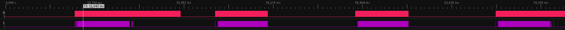

  • Ok, related to your last answer, we now have some support from our MCU vendor.
    Nevertheless, here is a capture showing the time spent in the HCI interrupt (channel 0) and the time spent in the decoding thread (channel 1). Can it work like this? It seems that we have time to perform everything but the synchronisation is not well managed (decoding is not performed when there are no any interrupts!).
    What is your opinion?
