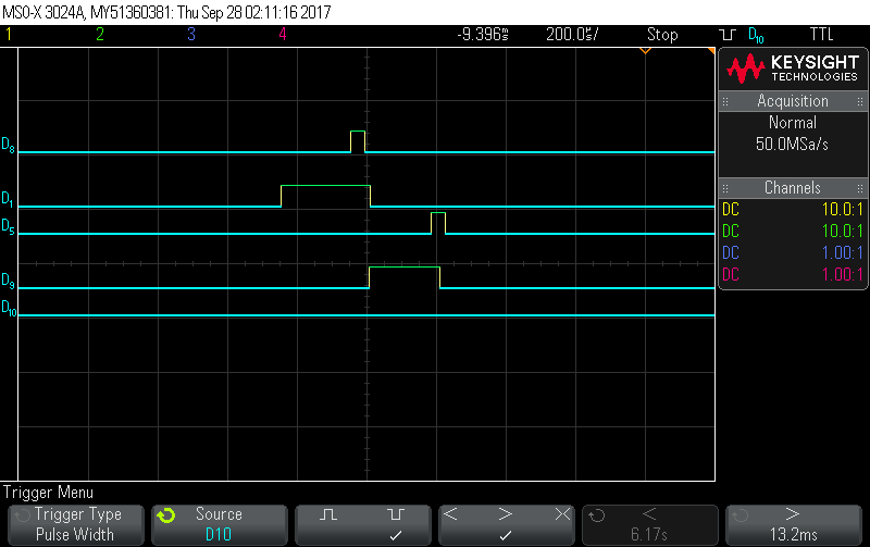

Following is a proper response:
D8: Master RFC_OBS_CTRL->0x31 , High from when the access address has been transmitted until end of packet, low otherwise
D1: Slave RFC_OBS_CTRL->0xAA, RX_active
D5: Slave RFC_OBS_CTRL->0x31,  High from when the access address has been transmitted until end of packet, low otherwise
D9: Master RFC_OBS_CTRL->0xAA, RX_active
D10: Master RFC_OBS_CTRL->0x30,  High from when receiver has found access address until packet is finished, low otherwise

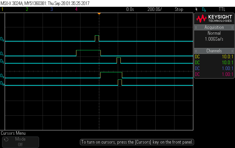

My failure occurs when the Master misses the Response from the Slave. The Masters RX_Active does not capture the the Slaves packet.
D9 should have extended the RX_active to capture the Slaves package D5.
Though sometimes, the D5 Timing completely misses the Masters RX_Active window.
So, what can I do to identify the cause?
What variable can I adjust to extend the RX_Active window, or shift it.

    From the scope, ideally the Transmit from the master should be more centered to the timing of the Slaves Rx_Active.
    And like wise, the Transmit from the Slave should be more centered to the timing of the Master Rx_Active.
    End Solution should be a setting to center the RF Tx/Rx, or increase the Rx_Active at a power cost.

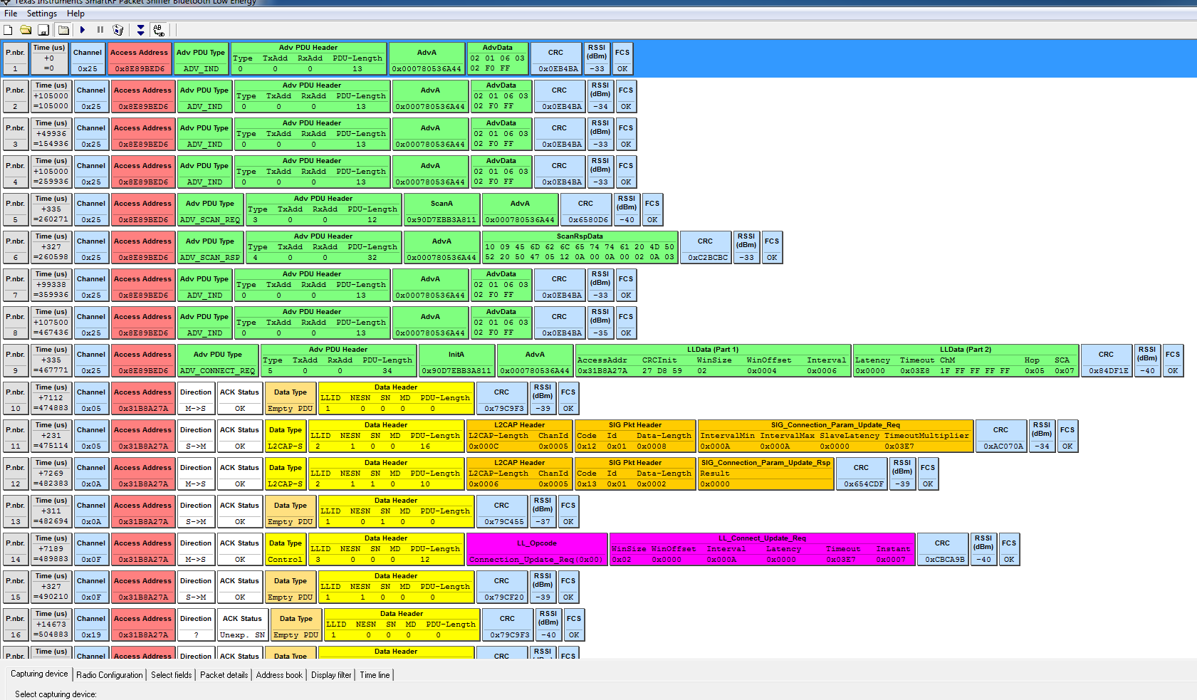

    Here is a sniffer snapshot of the connection, to provide you more information.
    I don't have exact details on BLE 1.2.1 since we no longer maintain this SDK version. As a data point, can you load BLE 1.4.2.2 on your module and check for the same condition? This will let us know if the issue is corrected on a supported SDK version.

  • Here is a more detailed snapshot of the package timing at the interval.
    First Snapshot is a proper communication, the second is where the Master missed the Slaves response package.
    Setup information:  10ms Intervals
    Observations:
    1. if the Rx_Active phase based on T_IFS is 150uSec, the RX_Active wastes a lot of energy since it starts 208uSec before the start of the Master Transit Package. This in my opinion is something that can be address and reduce the overall power consumption of the system.
    2. The measured T_IFS From when the Slave receives the Masters Package to when it sends is 176uSec.
    3. As pointed out in (1.) the Master Rx Active Starts very early than it should, wasting power in the Rx Active stage.
    4. On the package failure, the Master RX Active stage terminates after 200uSec and misses the the Slaves Transmit Package.
    So my questions are:
    A: how to I extend the Master Rx Active window? I tried setting the PPM to 500, but I am now questioning if I am doing it correctly.
    B: Can we shift the Rx Active window over by 100uSec to save Rx Power, and bring the alignment of the Tx/Rx more centered and not skewed to the end.
    Both A & B will provide a solution, but B would be best due to the direct power savings.
    Timing.pdf

  • I have made a graphically clearer image of what we are looking for. See Yellow drawn in traces.
    What is needed is a re-alignment of the Rx_Active stage of the connected intervals, relative to the anchorpoint.
    By shifting the Rx Active stage 100uSec to the right, you get:
    1. ~40% reduction in unused Rx_Active Power
    2. Tx Transmission now landing in the middle of the Rx_Active Stage
    3. Practically zero chance of missing a Tx package.
    This appears to not affect the Core_V4.0 standard, since I could not see a clear statement which indicates that the Rx Active stage needs start where it does.
    Again, it makes no sense to start it where it currently does, since we know that no Tx package is expected in that first have of the zone, relative to the anchor point.
    So, can we build a new beta library(s) that allows us to shift the start of the RX_active stage to gain the benefits of points 1-3.
    With my application, that does push the limits of the BLE due to overall thru-put, the accumulation of missed Tx Packages by the Rx Active window and normal RF interference is causing issues with my real-time application.
    Timing2.pdf

    In regards to the original problem and timing diagrams supplied by RRIO, after further investigation (I didn't give up), we have concluded that this behavior looks as what you would expect when you have a lost sync in the master (for instance due to interference). When sync is found, the RX time is extended to cover the whole packet, while when sync is not found, the receiver stops some time after sync would have been expected. If you look at the two plots, D9 in the second one goes low after D10 in the first one goes high. This means that the receiver was on long enough that it would have found sync if the sync word (access address) had been received without error.
    The time between the high pulses in D8 and D5 is also as expected. The time from rising edge to rising edge is around 230 us. An empty BLE packet is 80 us (8 us preamble + 32 us access address + 16 us header + 24 us CRC), so this corresponds to T_IFS of 150 us. Keep in mind that the signal goes high after the access address, so the pulses are much shorter than the actual packet.
    The timing in this case is not determined by the sleep clock accuracy (at least not for the master), since this is inside a connection interval. The timing in this case is done by the link layer engine. The RX_ACTIVE signal is a bit misleading for the master, as it goes high when transition has started, but the RX hardware is started a bit later. For the slave, the RX_ACTIVE signal also includes the synth calibration time, which has to happen before anything can be received. There is also some settling time in other parts of the receive chain. For the slave signal, the window widening also comes into account as previously mentioned, and increases when the previous connection event closed due to a missed event.
