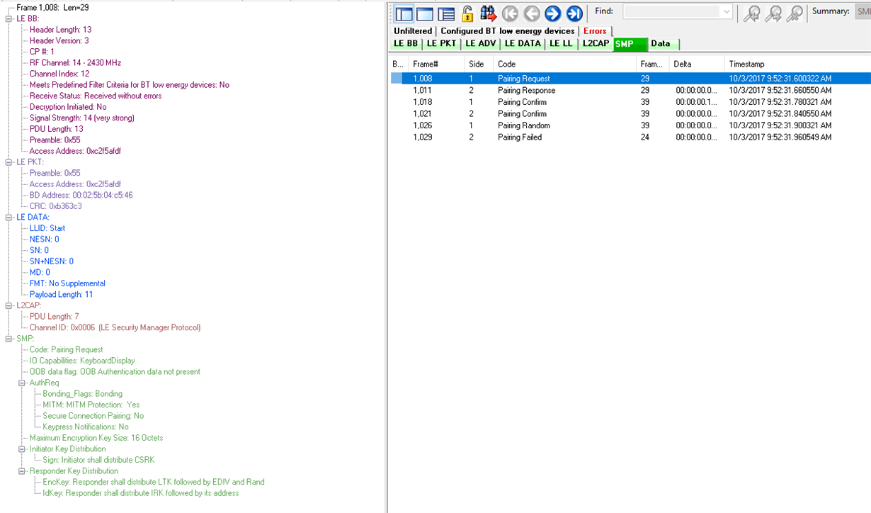

However, I never receive a PIN Entry on my central device. Can you tell me a little bit about what can be wrong. I spent a lot of time and played with different parameters for Bonding Parameters. However, still there is no result yet.
I thank you in advance!
  • Can anyone chime in?
  • Can you take a BLE air sniffer capture showing the pairing request/response and subsequent SMP operations? That would be a good starting point.
    Best wishes

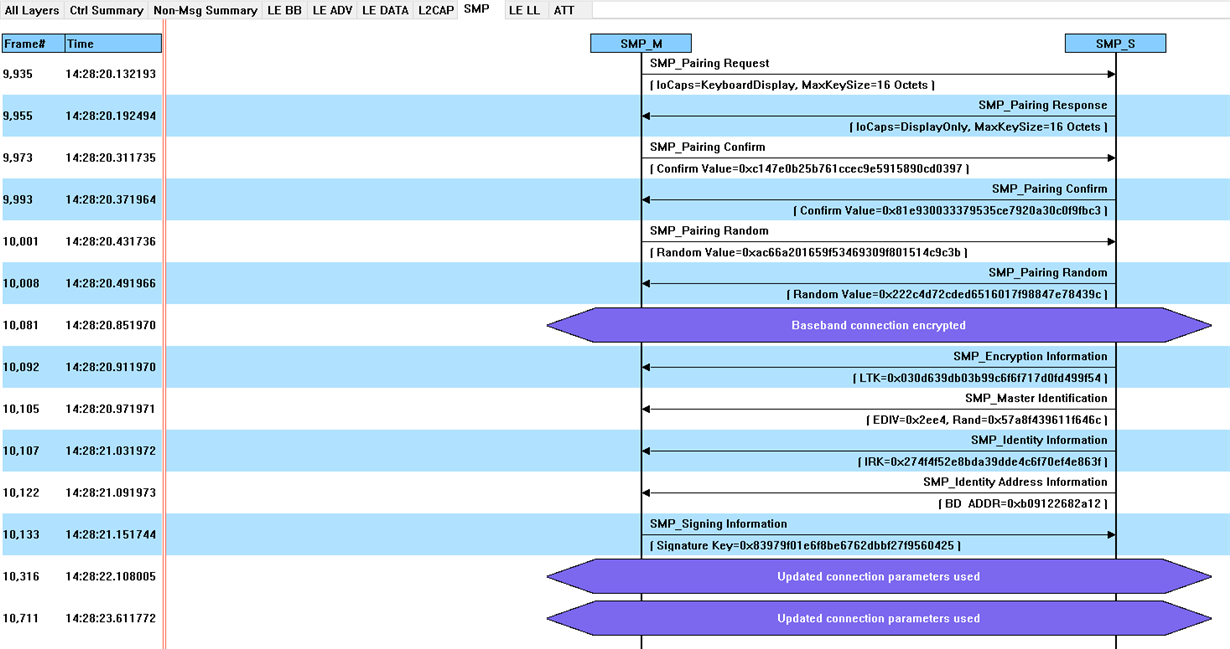

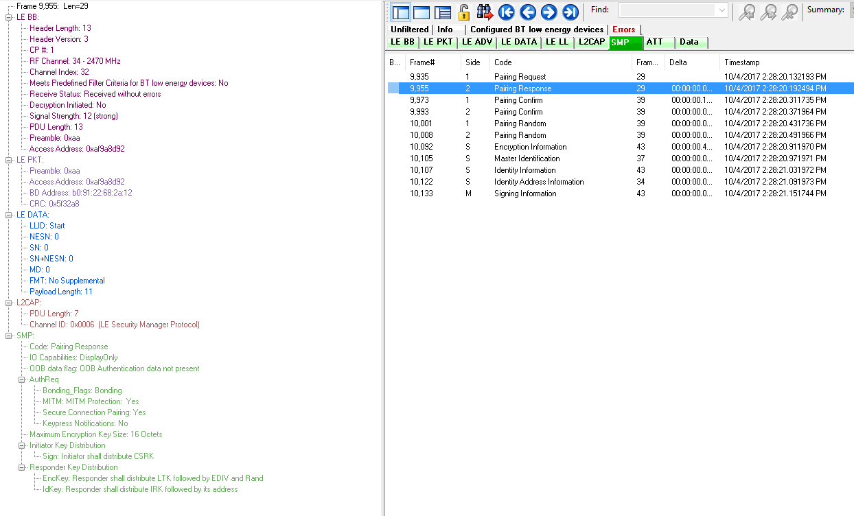

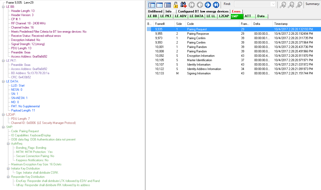

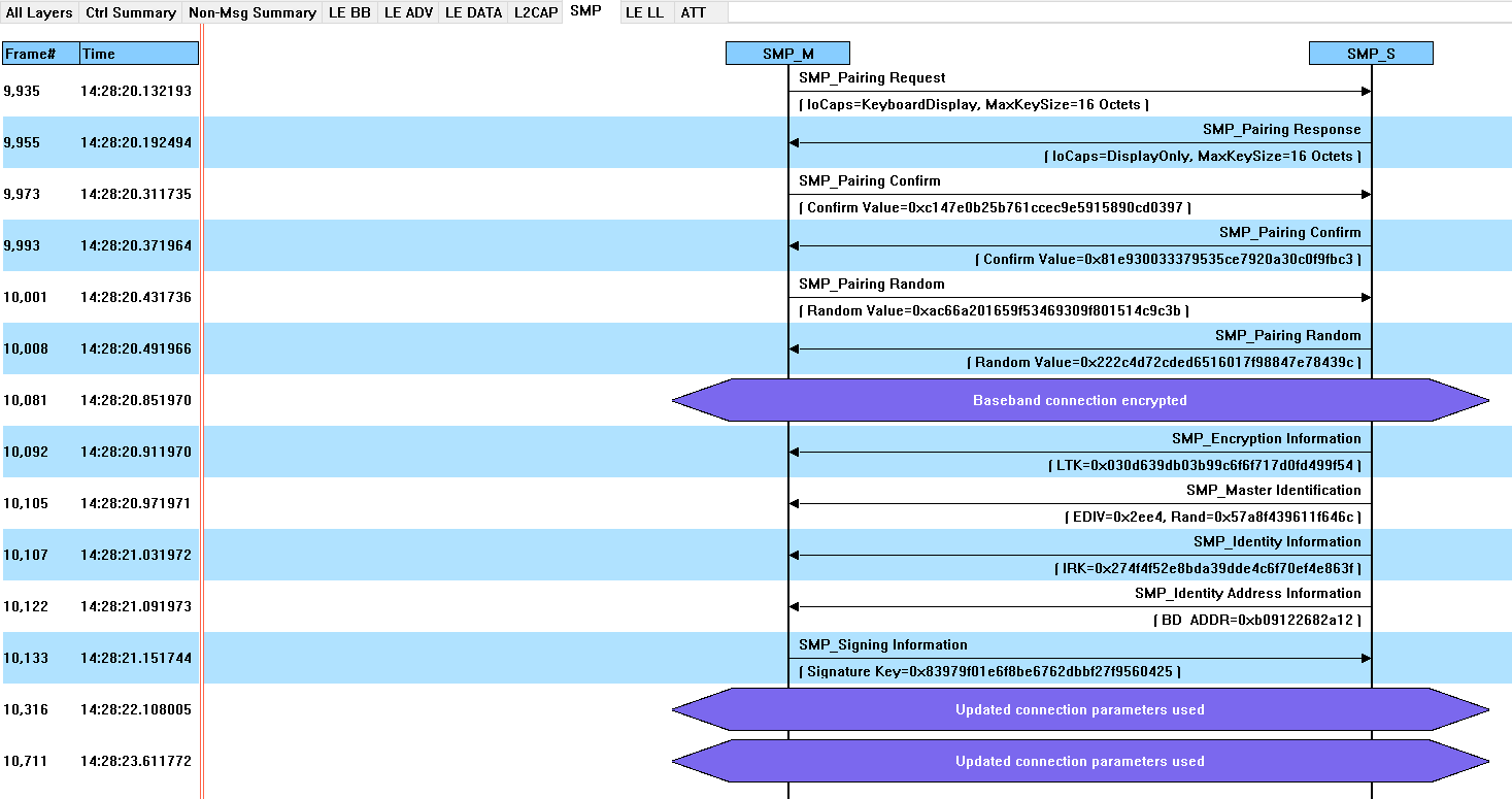

  • Hi there,
    I sniffed the air traffic with BPA low energy and here are the screenshots for SMP.
    Thanks for helping!

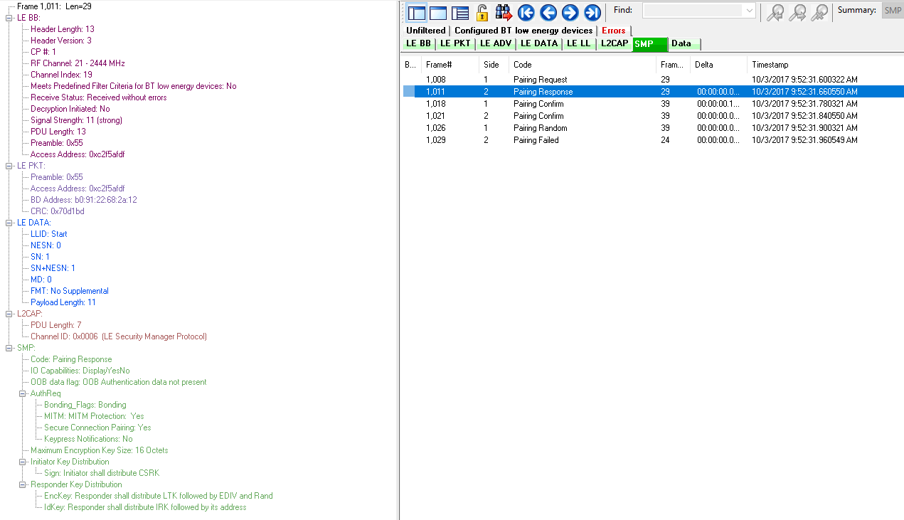

  • Interesting. By chance is your default passcode 000000? It's proceeding on with successful pairing as if the key code was entered correctly on the Initiator.
    Best wishes

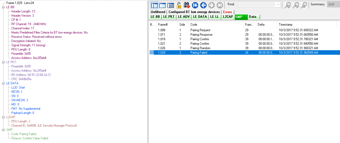

  • Exactly, my default pairing passcode was 000000. When I changed it to 123456 my central device rejects the pairing as following. Can you elaborate a little bit why I fail and how can I fix this?
    Thank you,
  • It looks like you need to work with the BLE provider for your central device(s) as they are not prompting for the passcode as per the SMP section of the BT core specification.
    Beyond that, have you tried setting your IOCap as "DisplayOnly" to see if that changes the behavior for this peer device? I know that will preclude LESC on other devices but it would be an interesting experiment with this device which doesn't support LESC anyway.
    Best wishes

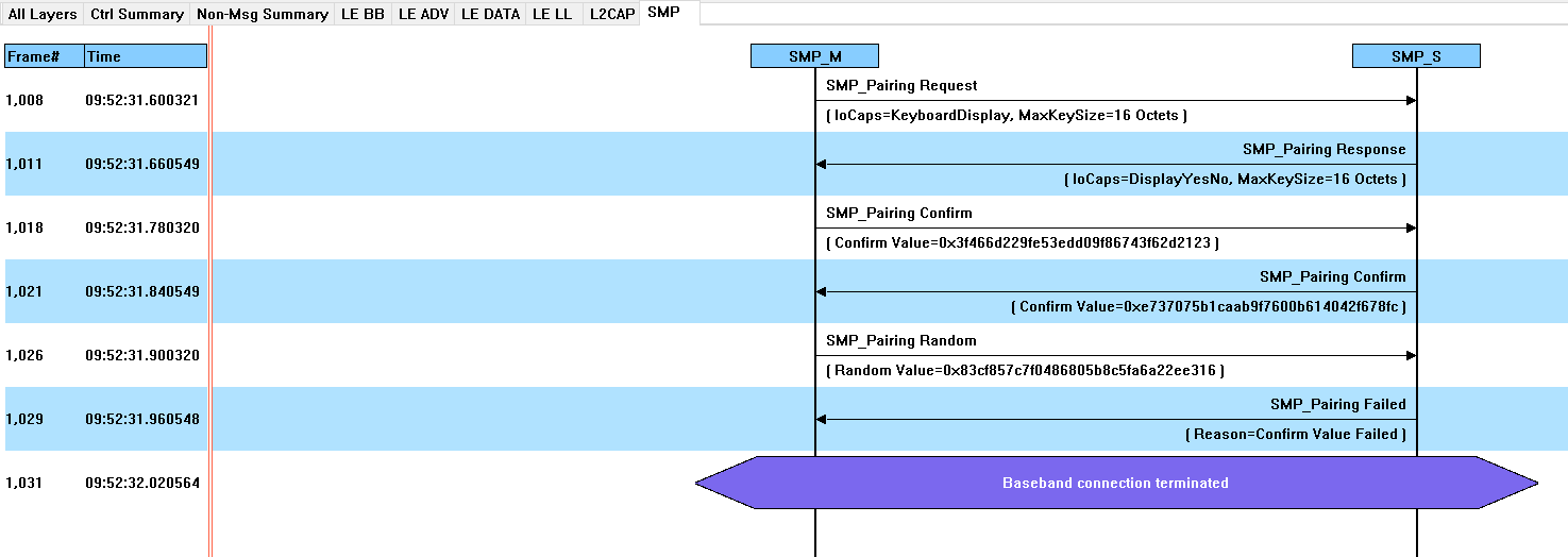

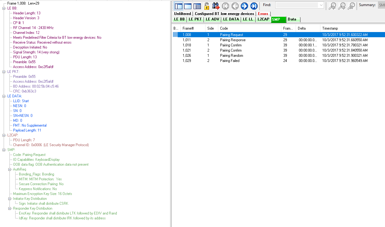

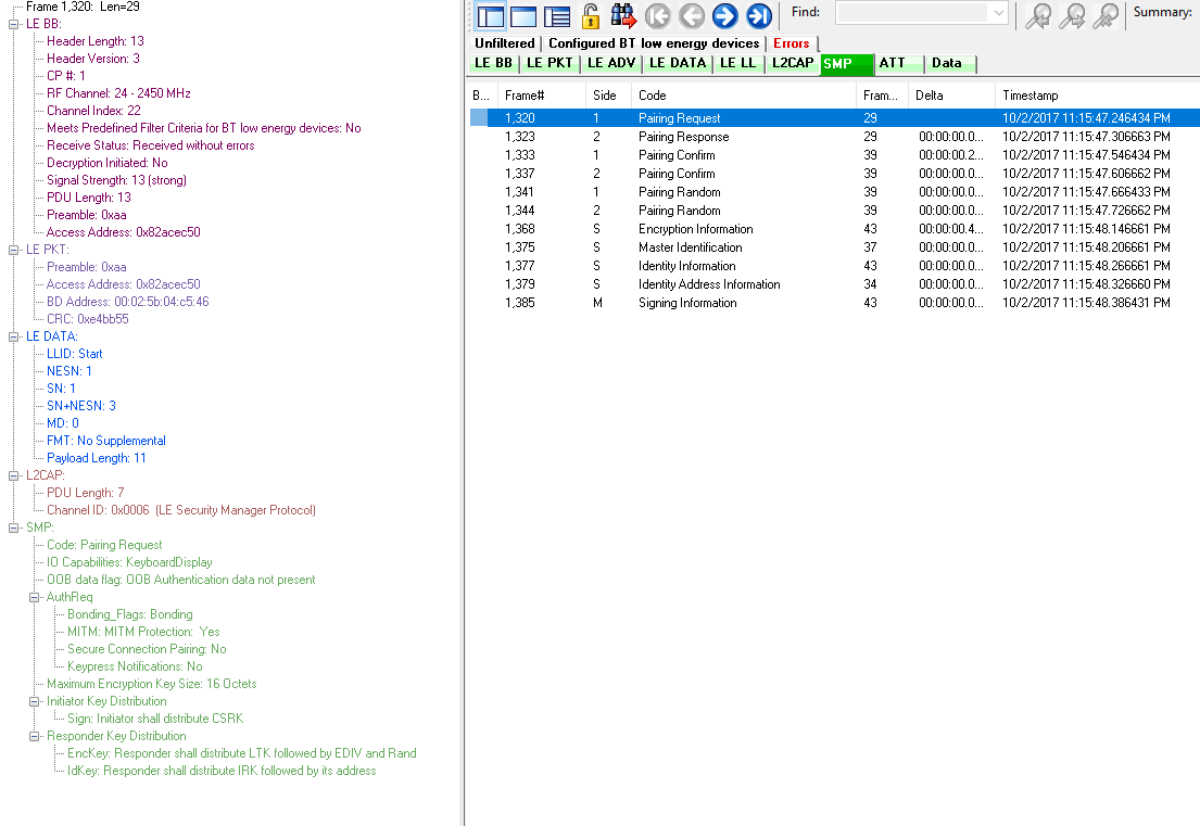

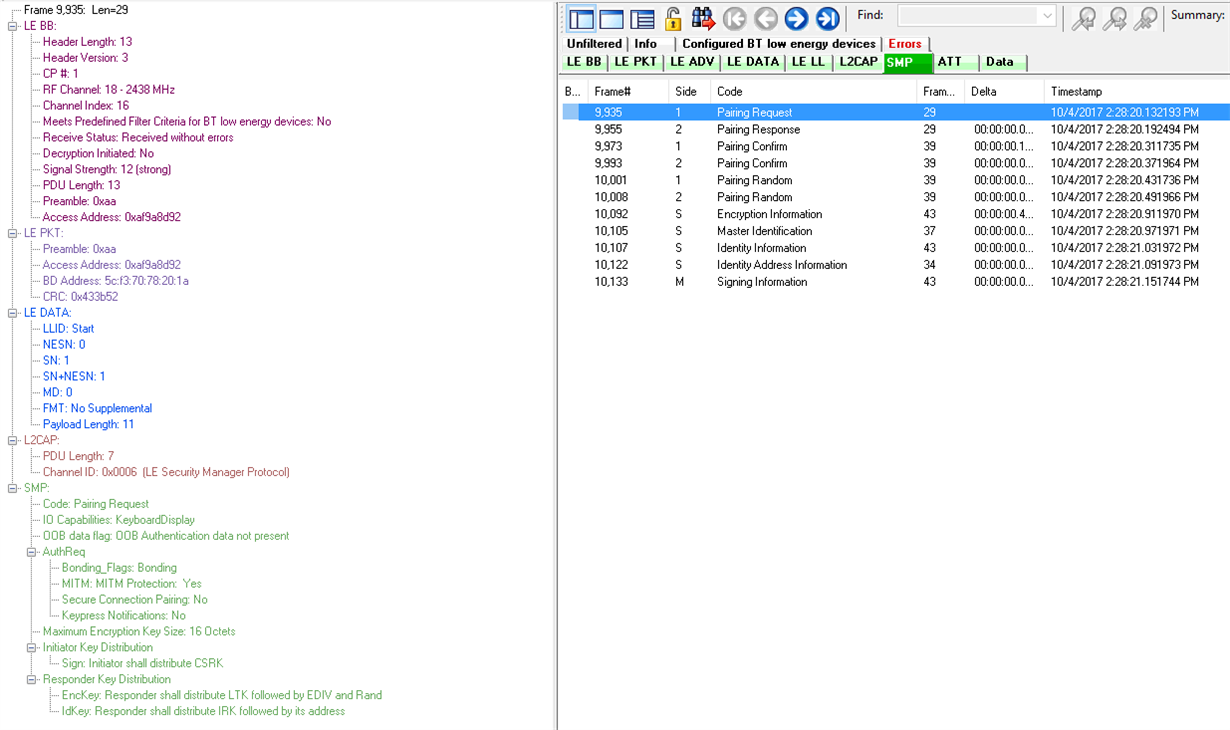

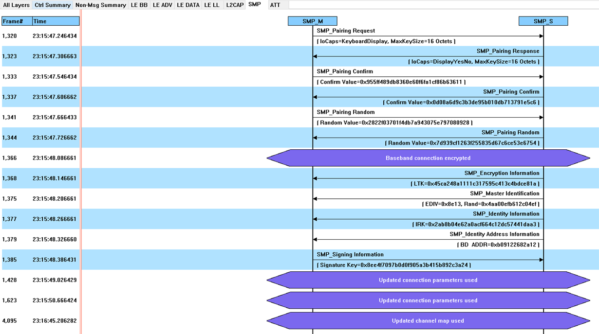

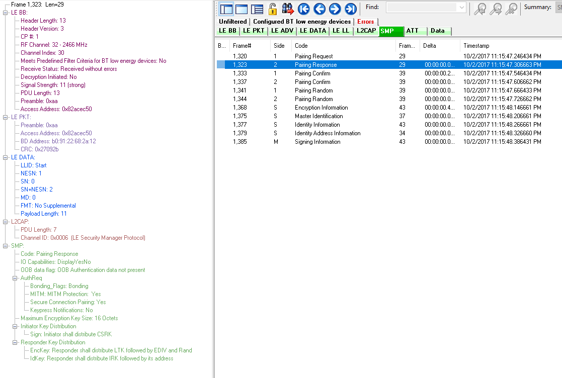

  • Hi there,
    I am using Windows 10 machine with latest updates. It has BCM20702A0 external BT Dongle. With my CC2640 with tirtos_simplelink_2_13_00_06 stack I can successfully do passcode pairing when I set the BT Stack to 4.1 configuration.
    With my CC2640R2, when I set the ioCap to GAPBOND_IO_CAP_DISPLAY_ONLY by doing:
    uint8_t ioCap = GAPBOND_IO_CAP_DISPLAY_ONLY;
    GAPBondMgr_SetParameter(GAPBOND_IO_CAPABILITIES, sizeof(uint8_t), &ioCap);
    I also set the passcode is to "000000".
    At the same time printing UART logs for gaprole_States_t on XXX_processStateChangeEvt(gaprole_States_t newState) and states with status on XXX_processPairStateEvt(uint8_t state, uint8_t status). Here are the logs:
    GAP State: 2 // GAPROLE_ADVERTISING
    GAP State: 6 // GAPROLE_CONNECTED
    Pair State: 0 Status: 0 // GAPBOND_PAIRING_STATE_STARTED
    Pair State: 3 Status: 0 // GAPBOND_PAIRING_STATE_BOND_SAVED
    Pair State: 5 Status: 0x14 // GAPBOND_PAIRING_STATE_RPAO_READ + ???
    Pair State: 4 Status: 0x14 // GAPBOND_PAIRING_STATE_CAR_READ + ???
    Note: These state and status codes are the same for when I set the ioCap to GAPBOND_IO_CAP_DISPLAY_YES_NO as well.
    Question is what does 0x14 status mean? I could not find in anywhere. I am also attaching the screenshots of sniffer again.
    Status 0x14 means bleNotConnected. See bcomdef.h.
    My best guess is they are getting into a different state based on the controller version or something else related to privacy.
    What is the Windows 10 build revision?
    Best wishes

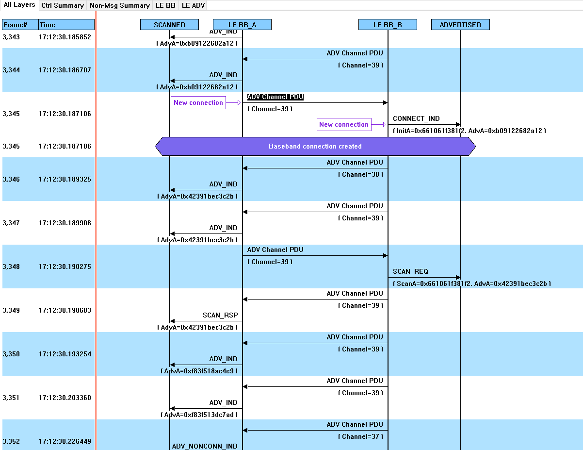

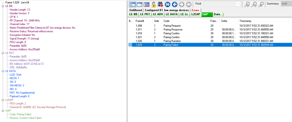

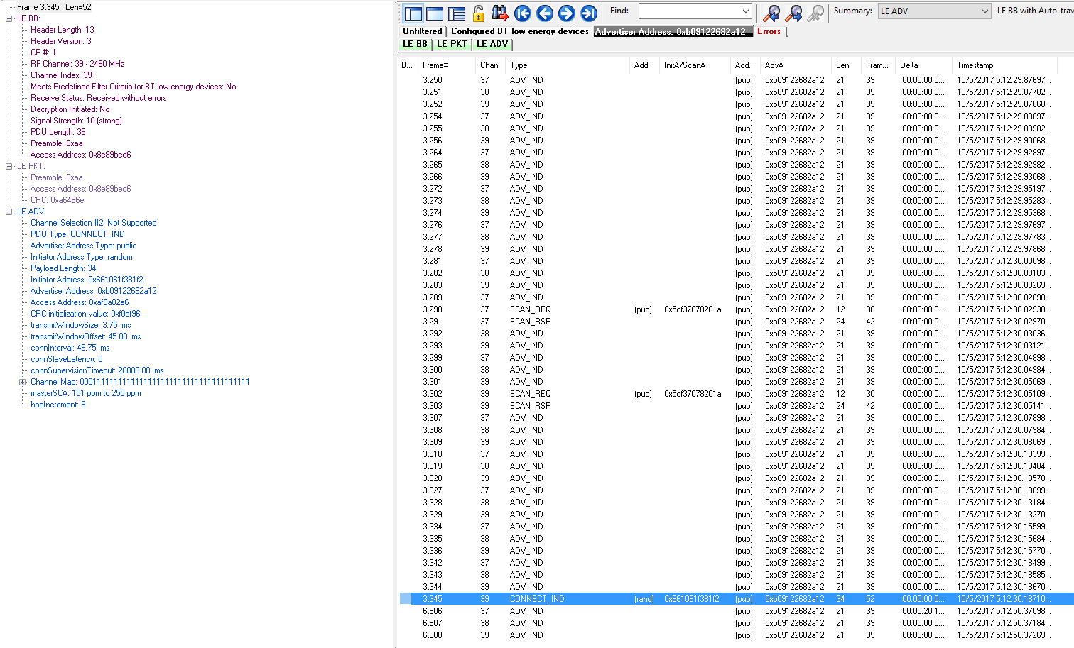

  • Hi there,
    Thank you for all responsive answers. I am running Windows 10 Pro Version 1067 OS Build: 14393.1715.
    Debugging is getting more interesting: When I try to pair with an Android Nexus 6 Phone running Android 7.1.1, it fails to continue after connected. Please see the attached screenshots. To me for now, it seems like the problem on CC2640R2 side.
  • Hi dnz,
    Of course, we are always guilty until proven otherwise :)
    It's difficult to make a conclusion from your sniffer screen shots (this is why we request the complete file) but I don't see any data PDUs after the CONNECT_IND. This would imply that the master (i.e., the handset) didn't transmit the first data PDU. Any thoughts on this?
    Best wishes
