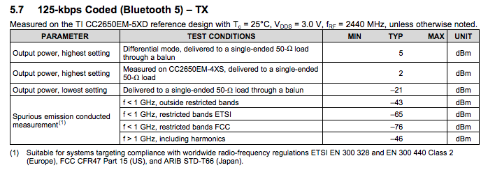

  • Hi Fredrik and TI Team members,
    I'd like to follow-up with another question regarding power consumption(as our application is ultra low power critical)
    I see the following from the datasheet:
    The above test was done at 3.0V VDDS. What we would like to understand is how the following two changes would impact the parameters above.
    The customer plans to use a singe ended RF output and is looking for the changes at the following:
    1.) VDDS @ 1.8V
    2.) VDDS @3.7V (Directly powering from Li-po)
    Thank you in advance,
    Omid Deylami
  • Hi Omid,
    Take a look at the "Typical Characteristics" section further back in the datasheet.
    Note that you cannot run directly from a LiPo as the maximum voltage of these is around 4.2 V.
    Fredrik
