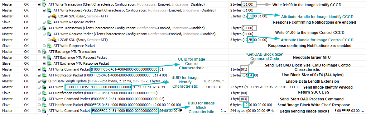

  • We solved the problem by adding delay between the parcels.
  • How can I increase the size of blocks? At us now the full packet sends on 20 byte. How to get to 244?
  • Hi Heinrich,
    This can be done by performing an MTU Exchange and completing the Data Length Update procedure as shown in the sniffer capture you referenced. Your downloader must be capable of supporting larger MTUs in order to get to a block size of 244.
