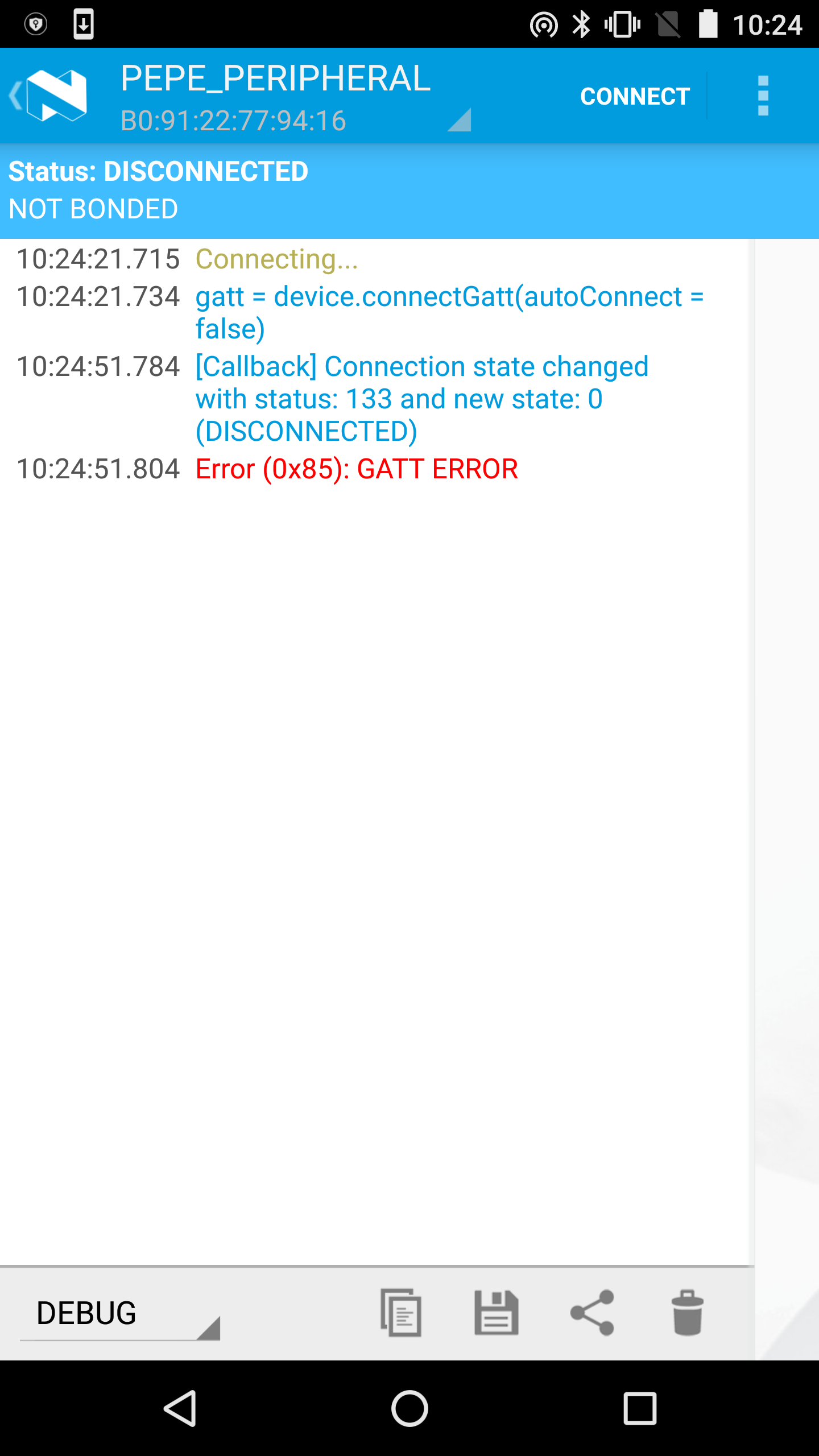

We have F1 sample based on CC2640R2F BLE chip and we created custom service to notify our data and that was working with our custom BVS Android app and also 3rd party apps.
With F2 sample hardware based on same chip, only we added SPI based communication + sensor controller feature, our custom BVS Android app or any 3rd part app doesnt work with few mobiles
When tested with python script using BLE blugiga dongle, our embedded code works without issues
We face different issues with different mobiles.. Few are listed below
Nexus 5 Android 6.0.1 - Working perfectly
Asus Android 6.0.1 - Not even getting connected

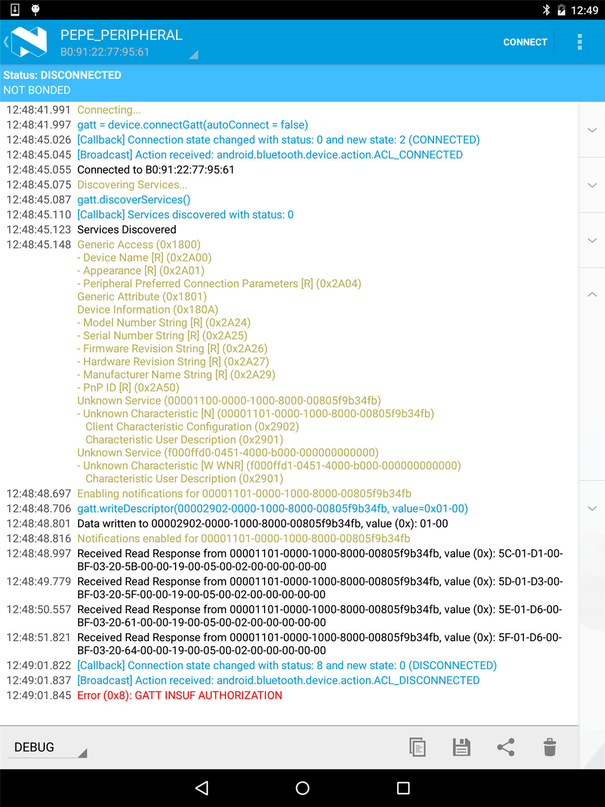

HTC Nexus 9 Android 7.1.1  - Getting connected but frequently app gets auto disconnected and connected
Xiaomi Redmi Note Android 7.1.1 - Getting connected after 30secs only
We captured mobile side and embedded side logs.
In mobile logs, it looks like due to connection timeout, app gets auto disconnected.

  • We disabled DLE feature and reduced connection interval also.
    Though this solved our issue, but in long run, we are still facing disconnection issue with few mobiles.
    Inconsistently, issue is seen with Nexus tablet running Android version 7.1.1 and Redmi note running Android version 7.0 as of now
    We are sending notifications to mobile and randomly after some "n"th packet, mobile app is getting disconnected and connected automatically
    When we checked the wireshark capture, we found that after the last notification packet being sent to mobile, master is sending connection event but slave is not responding for it and after 20s of supervision timeout, app is getting disconnected automatically
    We tried to reduce connection interval to 7.5ms in peripheral side but still the issue was seen
    Here connection interval is getting updated to 48.75ms after conn. update parameter req.
    Why the slave didn't respond after sometime is unknown?
    What are the possible scenarios that slave wouldn't respond to master connection event?
    Note - Using BLE BLUGIGA dongle, python script to get notification is working in long run always
    Attaching wireshark capture of disconnected issue
