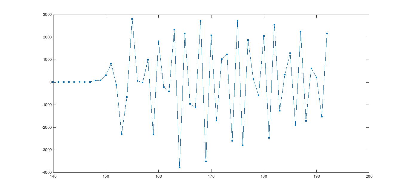

  • Hi, I have tested with 17Khz sine wave. My main requirement is time accuracy, now it seems this is fine.
    But I found that the audio signal sampled by sensortag has severe distortion when it comes to the audio wave shape. I plotted the sampled audio signal by Matlab, it can be seen clearly the audio wave shape distortion, this will affect further DSP process such as corss-correlation algorithm

    However, I feel that there is a possibility that the filtering inside the pdm2pcm16k() function may be affecting your waveform.

  • Hi, after my test, I think just modifying the BCLK frequency is enough for increasing the sampling frequency, the received audio waveform will NOT have distortion( I also tested the decimation filter), I hope people who do similar applications can see this thread
