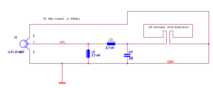

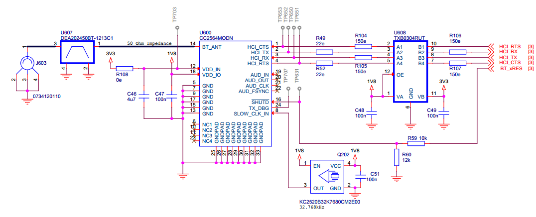

We have a CC2564MODN module connected to a STM32F412 CPU. The BT module is connected to the following PCB BT antenna: link.

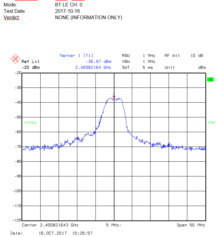

We are faced with an issue, that the transmit frequency is shifted by -1MHz for each channel.
For example, when selecting the BT LE Transmit Test Mode (as described in the TI wiki) we see the following center frequencies:
HCI_BLE_Transmitter_Test 0x201E, TX_Channel , Data_Length, Payload_Type
  • TX_Channel: 0 -> 2401 MHz, instead of 2402 MHz
  • TX_Channel: 19 -> 2439 MHz, instead of 2440 MHz
  • TX_Channel: 39 -> 2479 MHz, instead of 2480 MHz
TX Frequency: 2402 + 2*k, where k is the channel (max val is 39)
We get 2402+2*k-1MHz.
What could be the reason for this shift?

  • Hi Martin,
    The CC2564MODN has the fast clock (38.4 MHz XTAL) included in the module. So it is not likely that the clock is the problem.
    Please address the following questions to identify if it is a measurement error.
    1. Is this issue only observed on one board?
    2. The span of the spectrum analyzer seems to be pretty wide in the attached screenshot. Please set the span to ~2MHz with center frequency set to the channel frequency (2402+2*k) to see if you still see the same behavior.
    3. Is there any predefined offset on the spectrum analyzer? Or is the spectrum analyzer out of calibration?
    4. If you have another spectrum analyzer, do you see the same behavior on the second equipment as well?
    Vihang
  • Hi Vihang
    Thank you for your help! I will certainly raise the questions on Monday. However, I do not believe that the spectrum analyzer is the issue. The screenshot is coming from a certification lab for European regulation approvals.
    I did request to verify the BT RF FCC Modes, Continuous TX as described in the TI wiki - same result.
    They did execute the BT RF SIG Mode. With the result, that the Bluetooth Tester wasn't able to configure the BT module. They think, it's due to the frequency shift.
    I did request to test another unit - waiting on the result.
    We do use the HCI Tester, as described in the TI Wiki in the CC256x_Testing_Guide, with the following script. Anything wrong with it?

  • Hi Vihang
    The latest results from this day:
    • Verified that the SP has no impact. Tested with changed "crystal mode", with the result that the BT stack does not start anymore. Verified with old SP, same results.
    • The spectrum analyzer is not the issue, no offset, not out of calibration.
    • Additional plots of the spectrum analyzer.
      • Channel 0:
      • And channel 19

    • Verify with a different BT antenna. If this works, the BT antenna is the issue.
    BT antenna: Any comments?

  • Hi all
    This issue is resolved. Fortunately, it was not a HW related problem. The SP was not properly loaded, because it was assumed, that this is done by the application running on the STM32. After adding the SP loading to the test scripts as instructed here the frequency shift is not visible anymore.
    Best regards and many thanks for your support!
