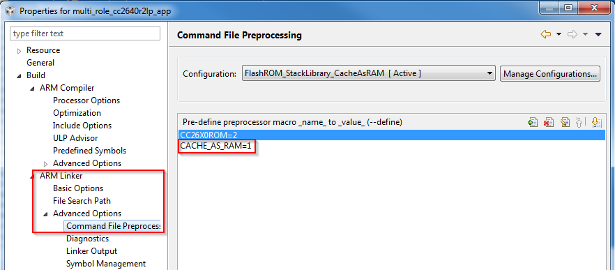

  • Moniaga,
    Having the linker file excluded from build is the normal use case and has to do with some link order dependencies.
    In any case, it is critical that the CACHE_AS_RAM=1 flag is defined in the linker options in order for the configuration to work.
    Please confirm that your linker screen looks like this
  • Yes, It looks like this.
