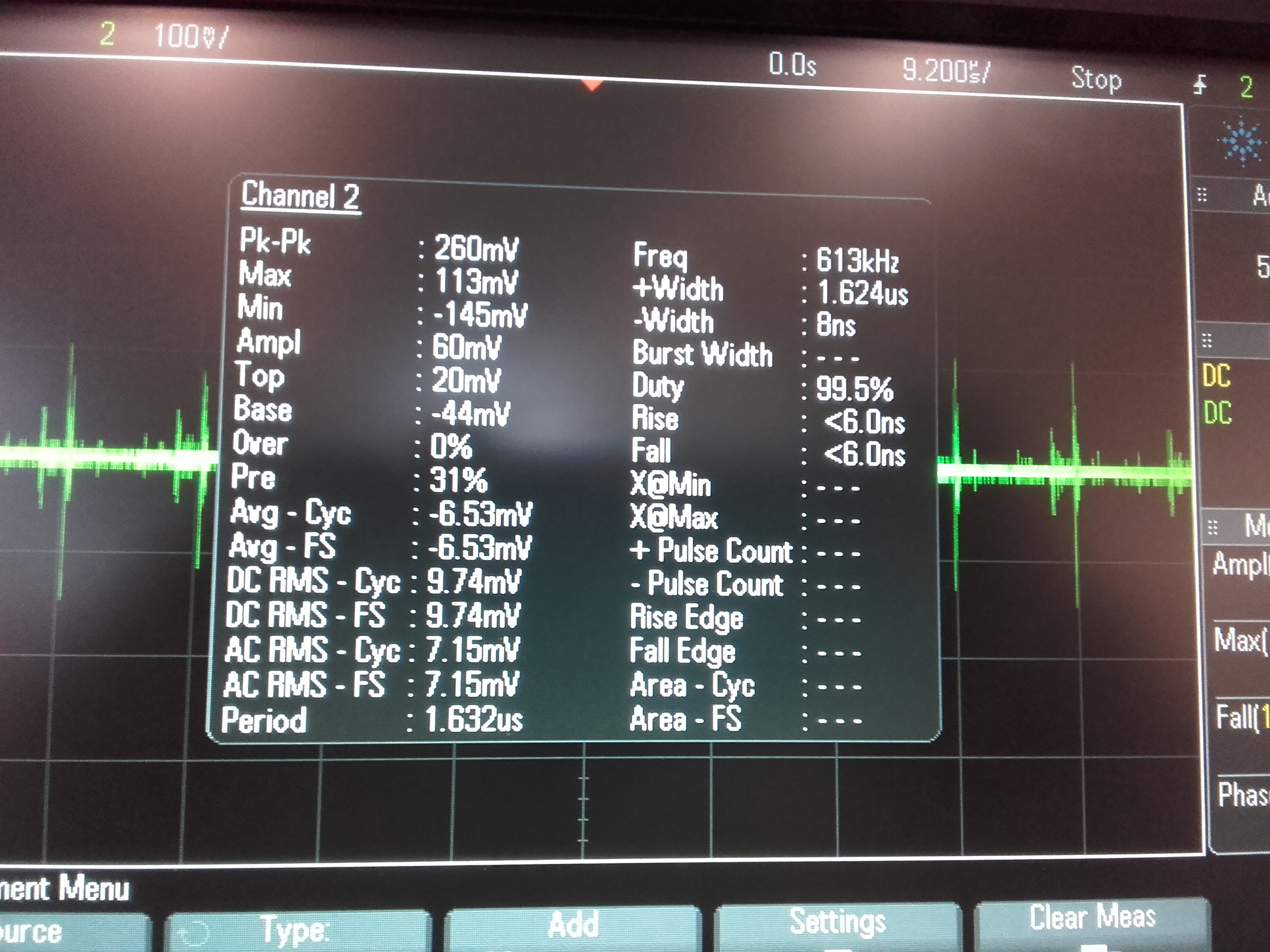

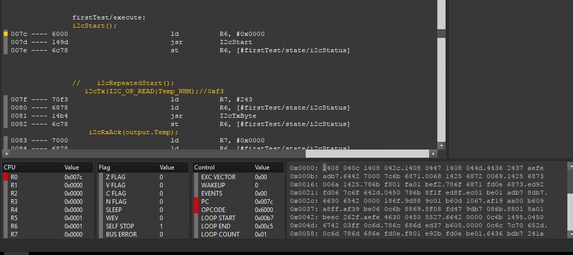

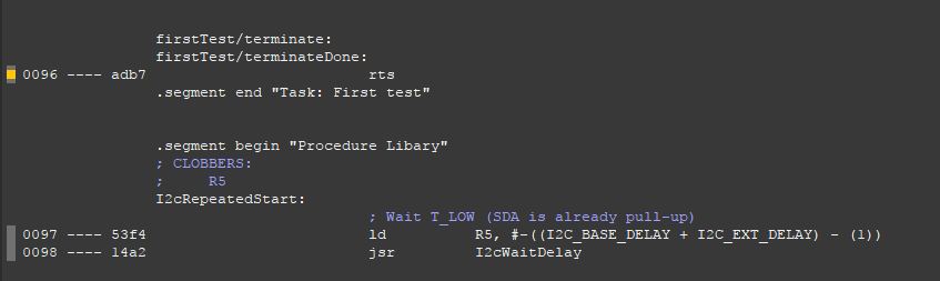

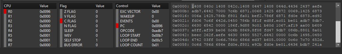

    I'm using  new sensor now. An SI-7021 on a spark fun brake out board. I've made the connections but I'm still getting the same results. I've connected the pins to an oscilloscope and I'm getting a steady wave form in the sensor frequency of 400KHz. Here are a few screen shots of the debugging errors. I've run your variation of the code with no success.
  • There appears to be an issue where there are bits being written to the register.
  • I've just noticed that the output from the clock pin on the oscilloscope is in the mV (~250mV p-p output) although the signal looks periodic its not square waves. I've tried multiple pins with the a different programs on sensor controller studio with no luck. Any idea what this issue could be. Is it a hardware malfunction or an Issue with SCS? The pins work for analogue I/O in project zero and the voltage pins appear to be operating fully.
