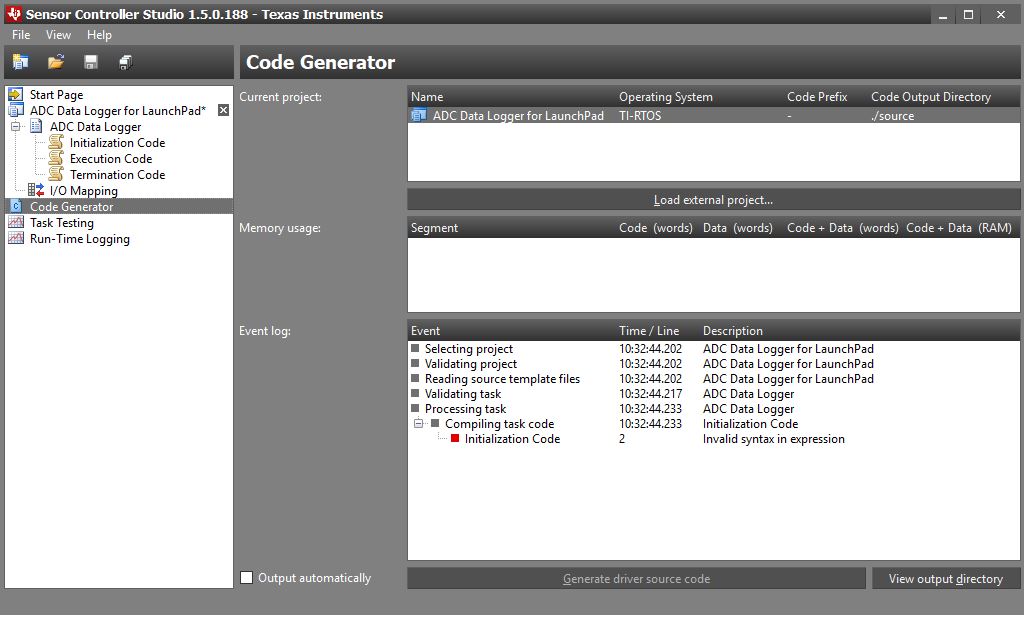

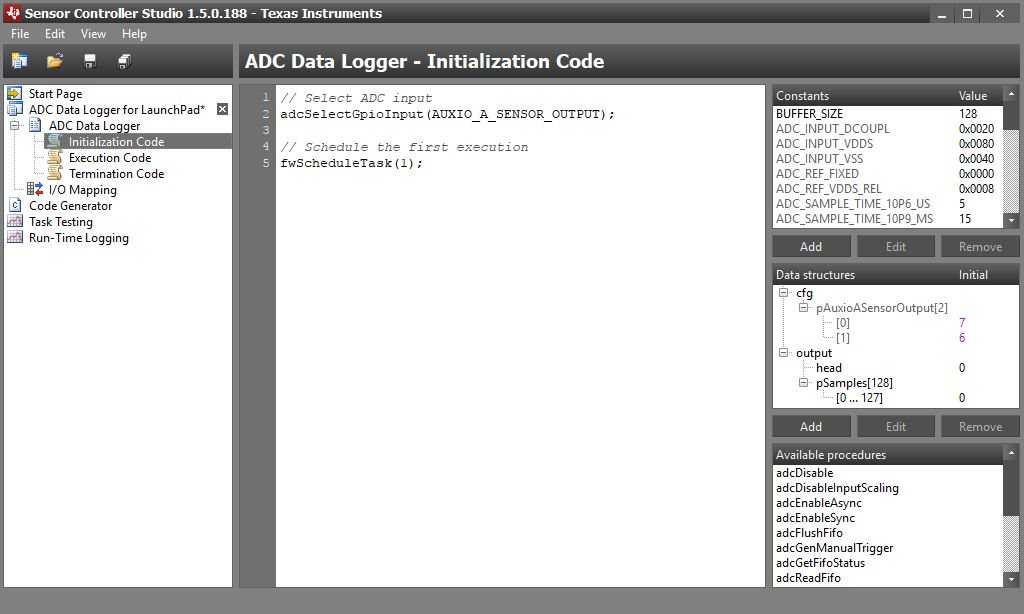

I'm using the cc2650 Sensor Tag, Sensor Controller Studio 1.5.0.188 and TI-RTOS 2.21.00.06.
I'm trying to familiarize myself with the Sensor Controller environment.
I can get the ADC Data Logger example to work but only when I use one pin and access it with a constant, when I select accessed by look-up table I get an error.
What seems to be strange is that the code doesn’t change at all. I don’t think that is supposed to be expected behavior.
Shouldn’t it be accessed in a loop with something like:
adcSelectGpioInput(cfg.pAuxioASensorOutput[n]);
It would be great if someone could post the working example code to acquire the data of several ADC Pins and buffer the output in a 2D Array.

  • Thank you very much for your support.
    Using the Sample Code I can not use the Logging function. And I have to weak up the main function for every value I read thus rendering the use of Sensor Controll pointless.
    How can I add a additional variable?.
    Even if I just use a functioning code and change n to i, I get an error.
    It would be great if I could use another local variable so I can implement some thing like this:

  • FYI: I found a working solution:
    for (U16 n = 0 ;n<INPUTS;n++){
    adcGenManualTrigger();
    n=n+output.head;
    adcReadFifo(output.pSamples[n]);
    n=n-output.head;
    utilIncrAndWrap(output.head+2, BUFFER_SIZE; output.head);// BUFFER_SIZE has to be a multible of INPUTS (output.head+2=output.head+INPUTS-1)
    // Disable the ADC
    adcDisable();
    // Schedule the next execution
    fwScheduleTask(1);
