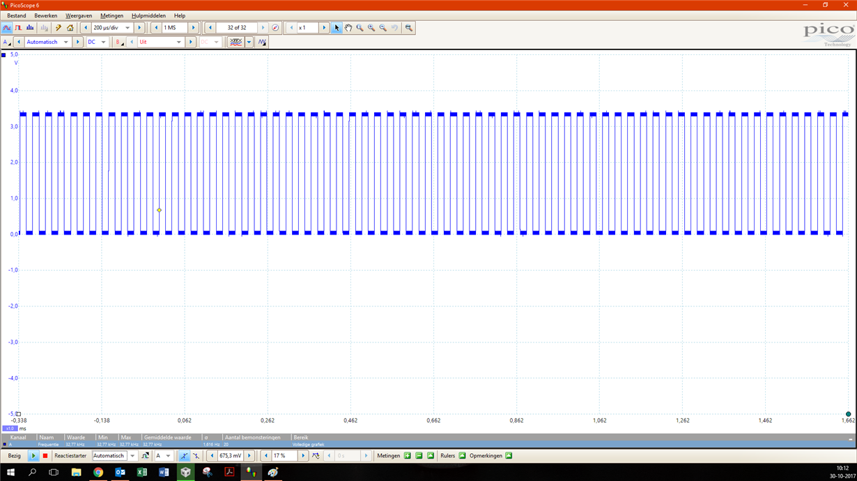

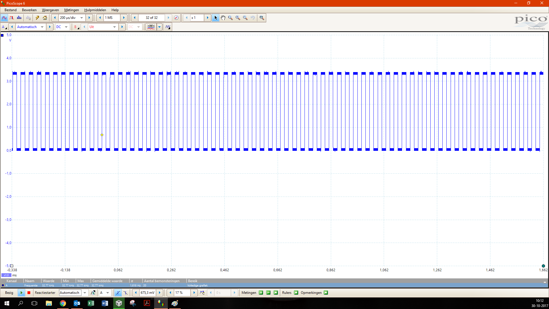

  • I have mapped the 32kHz crystal to an DIO pin and measured it with a scope. The frequency is about 32,77kHz so it looks fine to me. Image added below.

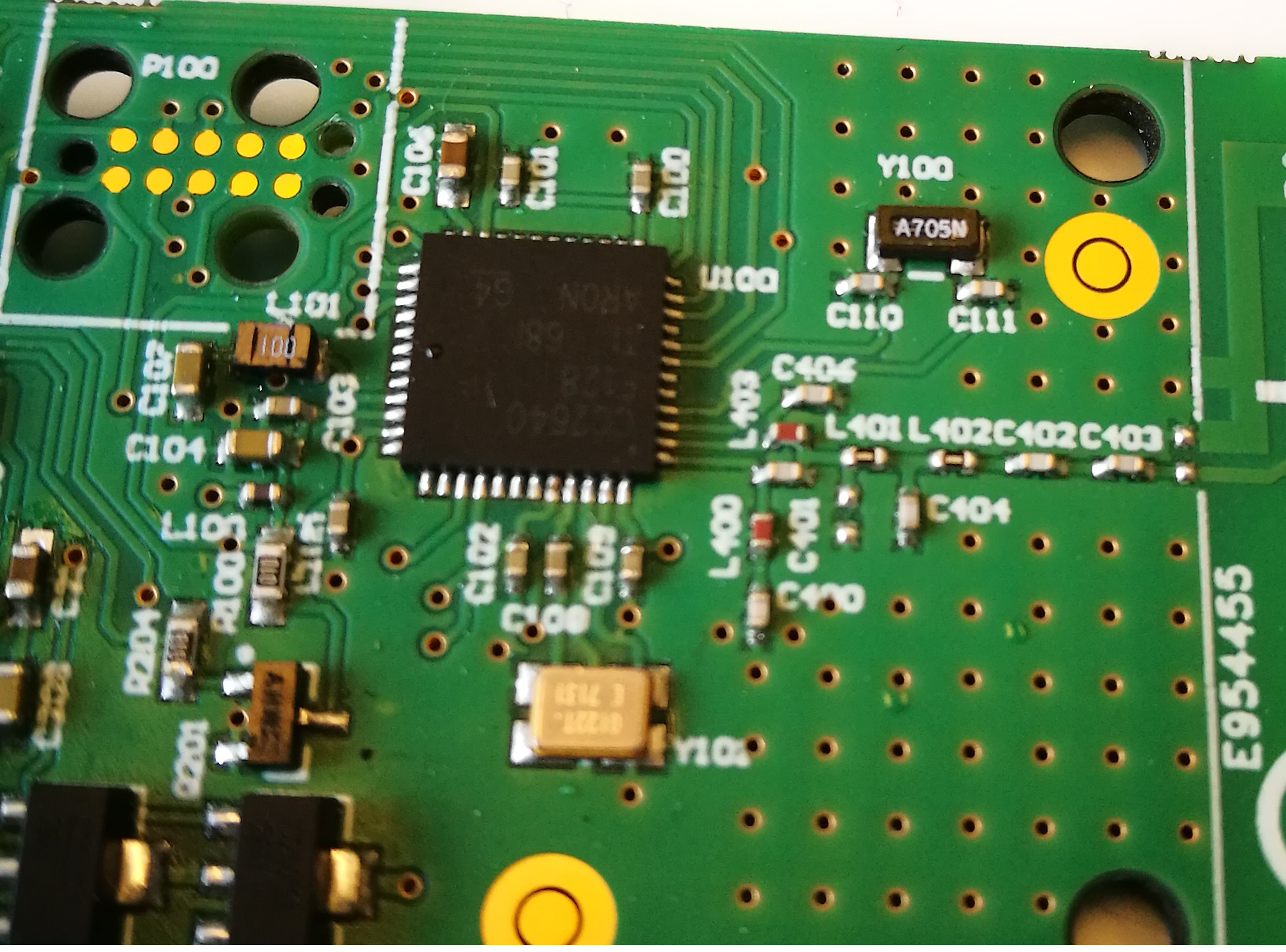

    Also for additional information on the layout, an image of the circuit on the MCU side:

  • 32.77 kHz is 60 ppm off, so it is not exactly spot on.
  • I tried to measure the same pin with the same method on the CC2640R2 launchpad, and got the same result of 32,77kHz.
  • Is the instrument rounding off? Can you measure with a proper frequency counter?
  • Ah, that works a lot better. I now used a Keithley DMM7510 in frequency mode.
    Launchpad CC2640R2: stable 32.76795 kHz
    Custom board: varies between 32.77013-32.76986 kHz
    EDIT: One of the older versions where Bluetooth worked a lot better also had a frequency between 32.77013-32.76986 kHz

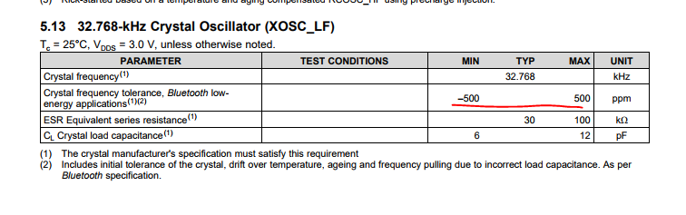

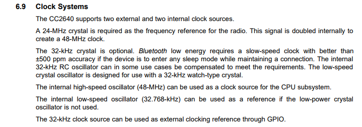

  • these last few days I have tried to edit the low frequency crystal multiple times (by exchanging load capacitors for different values in case my stray capacitance would be problematic) without any improvement in BLE performance. The datasheet of the CC2640 also indicates that the max tolerances of the crystal are +/-500ppm, which I do not exceed.

  • Last update for now. The problem is not completely solved, but I found where the cause is.
    By turning off the power saving mode, I prevent my code from using my externel 32kHz oscillator. Now it seems to work perfectly fine. It is however only a temporary solution, but now I know it's a PCB layout problem.
