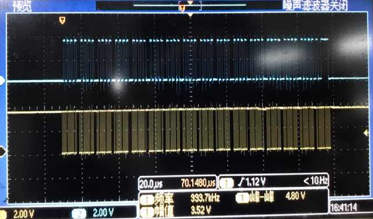

Hi
I use SPI slave + DMA to send data.  It's running well if data length shorter than 8 bytes. It will lose data if length longer than 8 types. Could you let me know to handle when longer than 8 bytes? Thanks.
