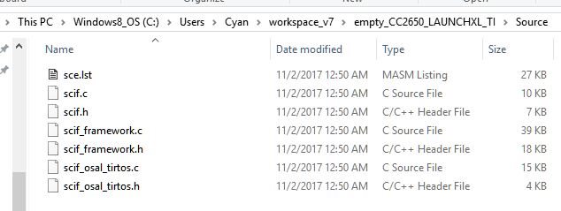

I am following one of the tutorial lab on TI website. Everything works well until I generated the code out from SCS to CSS.
Here is the tutorial that I followed:
dev.ti.com/.../sc_01_project_from_scratch.html
 I am stucked on the TASK4. (Cant find the main_tirtos.c file)
The files I generated did not have the  main_tirtos.c  like the picture shown below.
I also try to generate the example code. It has the main file contained when I generate the code. I am wondering which part would go wrong in my own project that started from scratch.
Thank you very much.
Cyan
  • The main_tirtos.c file should have been generated in task 1 in the tutorial.
    My suspicion is that when you did the setup of your SCS project, you did not set this: "Set Source code output directory to ./." correctly causing the SCS files to end up in a different folder than the empty project files. Do a search in windows for the main_tirtos.c file.
