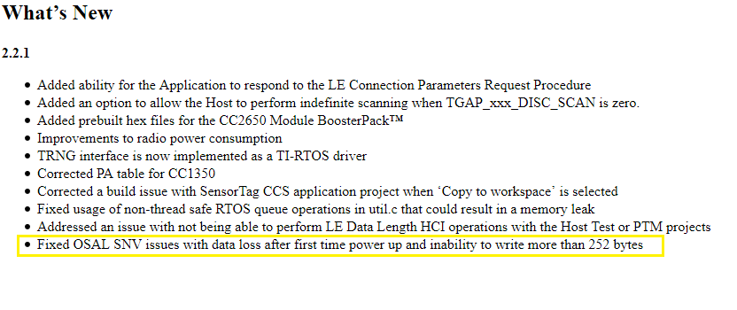

I modified the SimpleBLEPeripheral example to store data to the SNV Flash memory, I'm able to do write and read when the
cc2640 is powered but once the power is disconnected and reconnected again, all the data in the flash is also lost,
how can I solve this issue?
