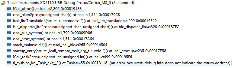

    But still no luck. The program fell into a while loop in BLE stack:
    And the calling stack:
    I also tried to increase ICALL_MAX_NUM_ENTITIES, ICALL_MAX_NUM_TASKS, and OSAL_MAX_NUM_PROXY_TASKS, didn't work either.
    Just don't understand, I call GATT_Indication in my task, and it works. I call GAPRole_StartDiscovery in my task, and it refuses to work! Any ideas or possible reasons for this?
