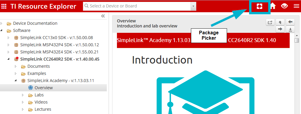

    Which version of the BLE5-Stack are you using? What concepts are you having trouble understanding? PHY switching? I would recommend going through SimpleLink Academy in the SimpleLink CC2640R2 SDK v1.40.00.45. This version of SimpleLink Academy contains both BLE-Stack and BLE5-Stack Project Zero example projects and instructions on how to use the stack features.
    http://dev.ti.com/tirex/#/?link=Software%2FSimpleLink%20CC2640R2%20SDK%2FSimpleLink%20Academy%2FOverview
    Use the package picker tool to switch SDK versions:
