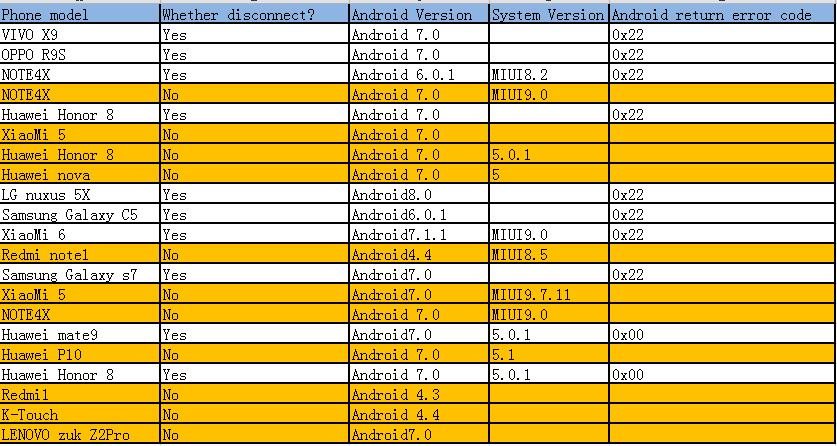

When I use CC2640 MultiRole Demo, set CC2640 as peripheral device connecting to Android phone. Some brands of Android phones will encounter disconnection, the Android return error code is 0x22 (HCI_ERROR_CODE_LMP_LL_RESP_TIMEOUT).
