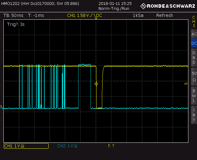

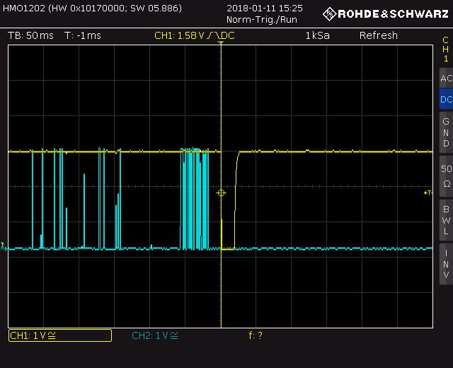

    It took some time, but we have checked the TMS,RST and TCK lines now.
    It looks like the reset is not the last thing happening when flashing from code composer studio in debugging mode.
    note: yellow line is RST, blue is TMS/TCK. TCK is first image, TMS second.
    I guess this is normal when using the debugger interface
    When flashing from Flash programmer 2 the last thing to happen is the reset.

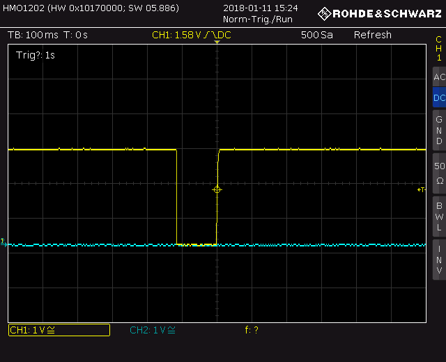

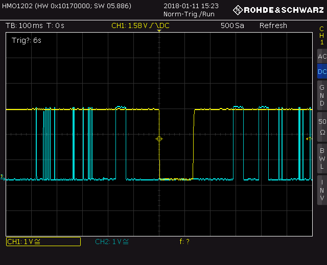

    I added the pictures from pushing the resetbutton on the CC2640R2F_LAUNCHXL devkit also
    Also, I added the screenshots from when I read a page from the flash(and the following reset as the FP" do a reset on the chip)

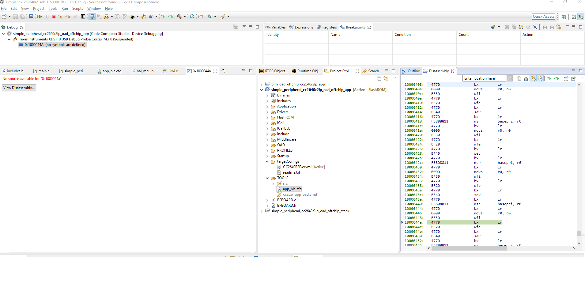

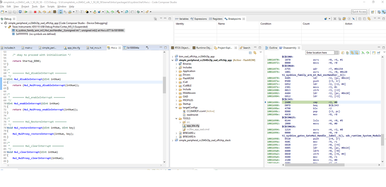

    When I suspend the debugging, and do a restart of the code with the restart button, the code will not run the first time I do this. I have to do a second suspend, and then a restart again, and the code run as it should. (there are no resets happening here)
    On the first suspend, code stop somwhere in the 0x1XXXXXXX section.
    On second suspend, code stop in the cmp command in the m3_exechandler.
    After second suspend, the code run normally when restarted.
