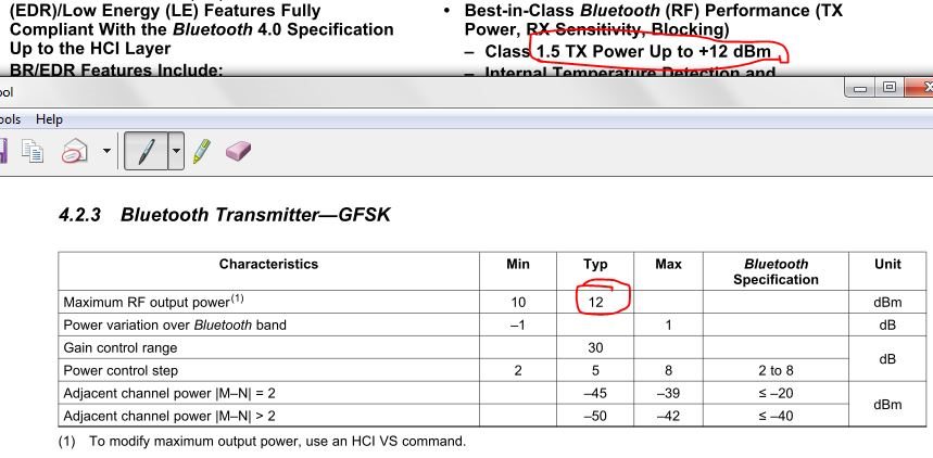

Our customer has a problem about CC2564B Max output power, in our spec, the Max is 12dbm, but customer told that they found some chip can be 18dbm in output power.
customer want to know what's the real MAX output of CC2564B? they want do the screen in production line.
thanks in advance.
LEON
  • Hello Leon,
    Even though the chip output power can be higher than 12dB.
    In order to comply with different certifications we can't transmit at a power level which will fail certifications.
    Please let me know what exactly is needed and i will help you get the data.
    BR,
    Chen Loewy
