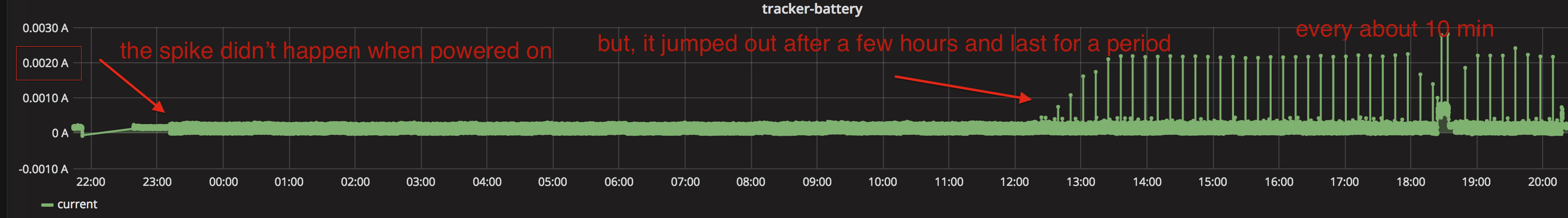

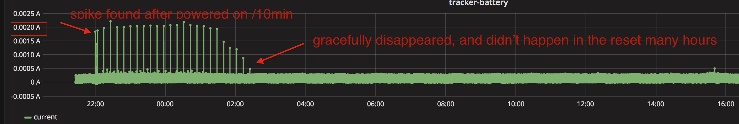

My issue is related the current spike things as showing below.
In the first test case, the current spike was found after powered on, and it happened about every 10 to 12 minutes. After about 4 hours without any action, it disappeared gracefully, and not observed in the reset a few hours.
I repeated the test case again, this time it didn't happen at the beginning, but somehow it happened in the middle and last until the end of the test.
So, can any expert tell me what is going on? Is this something configurable in the cc2640r2_sdk_1_50_00_58? or let me know how should I debug this issue?

  • Hi David,
    It looks like the CC2640R2F wakes up periodically for some reason. How often are you polling the MPU9250? What happens if you disable the motion sensor completely?

  • Hi Fredrik,
    Thanks a lot for your quick reply.
    I forgot to mention, I poll the MPU9250 every second if BLE is connected, otherwise every 2 seconds and saving the data in external flash. Therefore, in my case, the MPU9250 should never sleep, and CC2640R2F should wake up either every 1 second or everY 2 seconds, but the current spike pattern seems not matching any case.

  • I found this issue is related with external page erase, but it happens randomly and once happened it lasts for a few hours and then disappears automatically. So far, no clue what is the root cause yet.
