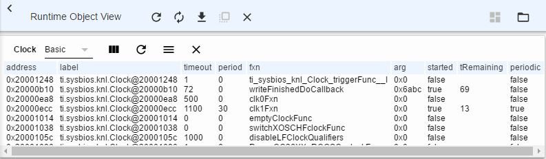

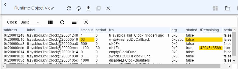

  • When i halt the targeti get the following messege.
    "Can't find a source file at "/db/vtree/ademars/git_trees/avala-v/src/ti/sysbios/family/arm/m3/Hwi.c"
    Locate the file or edit the source lookup path to include its location."
    I have also attached the ROV snapshot.
    Above snap is when it works normally and the image below is when it halts.
    I'm not sure where the bug could be, but...
    Taking another look at the Clock module documentation [1], the clock functions are called in context of SWI. The default UART write mode is UART_MODE_BLOCKING, so UART_write should be called in context of a Task.
    You may want to try modifying your code so that you have a task that does the ADC sampling and UART write. The task should pend on a semaphore. All the clock function should do is post to this semaphore at your desired period.
