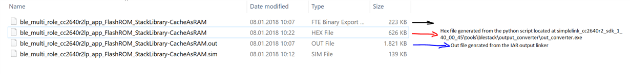

  • Hi Tom,
    Is there any solution? When i compile the multirole application with FlashROM_StackLibrary-CacheAsRAM. It generates the following set of files.
    I tried to flash hex file with the IAR it shows the error i have mentioned in the first post.

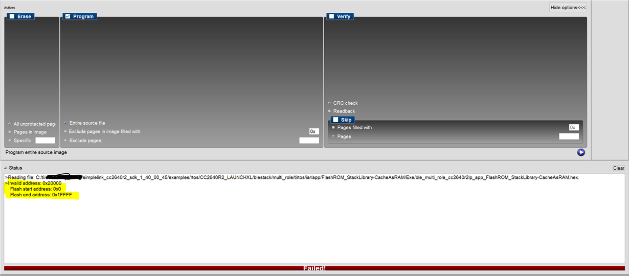

    When i tried to flash the files using Smar RF flash programmer 2
    While flashing out file:
    It shows following errors:
    While flashing the hex file: it shows following error:
    I have attached the python script which is at location C:\ti\simplelink_cc2640r2_sdk_1_40_00_45\tools\blestack\output_converter. I have attached it as text file as .py extension was not being attached.
