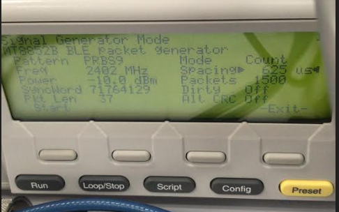

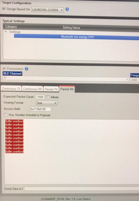

Customer using Anritsu MT8852B to generate test packets and CC2640R2F Launchpad with SmartRF Studio in Packet RX mode.
Sending 1500 packets at 37 bytes pkt length with spacing of 625usec, they get buffer overflow on SmartRF Studio.
What is the supported Packet RX rate (spacing setting) for CC2640R2F & SmartRF Studio?
