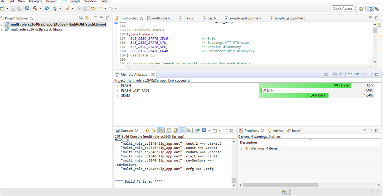

I'm working on multirole project on stack simplelink_cc2640r2_sdk_1_40_00_45, XDC tools 3.50.4.43 and cc2640r2f custom made sensortag devices.
I'm trying to do offchip oad using ble5_bim_oad_offchip_cc2640r2lp_app and multi-role project but during linking I'm getting the following error:
"C:/ti/simplelink_cc2640r2_sdk_1_40_00_45/source/ti/ble5stack/common/cc26xx/ccs/cc26xx_app_oad.cmd",
line 266: error #10099-D: program will not fit into available memory. placement with alignment fails for section ".const" size 0x1010 .
Available memory ranges:
FLASH size: 0x1dff0 unused: 0x11b8 max hole: 0xfb4
error #10010: errors encountered during linking; "ble5_multi_role_cc2640r2lp_app.out" not built
Has anyone faced this issue?
Can anybody help me with this issue?
Please advise. Thanks.
    It is entirely possible that you do not have enough flash memory available for BLE5 Multi Role on CC2640R2F.
    What is the build size of your application before adding OAD?
    In general the requirements for offchip OAD are 1 pg of flash and the additional code consumed by the OAD profile.
  • Hey Sean,
    The hex file before adding OAD is 239 KB
    The picture of memory allocation is as shown below:
    Can you please tell how to free up memory?
    Thanks.
    The hexfile isn't a true measure of the size of the binary image created by the compiler, it includes other header information such as addresses, lengths, and checksums. You can read more about one common format (Intel Hex) here:
    A better measure is instead to inspect the map file For example, I built the stock ble5_multi_role application and it gave me this:
    MEMORY CONFIGURATION
            name            origin    length      used     unused   attr    fill
     FLASH                 00000000   0001f000  0001cea8  00002158  R  X
     FLASH_LAST_PAGE       0001f000   00001000  00000058  00000fa8  R  X
     SRAM                  20000000   00004400  000028a4  00001b5c  RW X
    Based on the table above from the stock multi_role app it appears you should have enough memory to add off-chip OAD.  (~12k)
