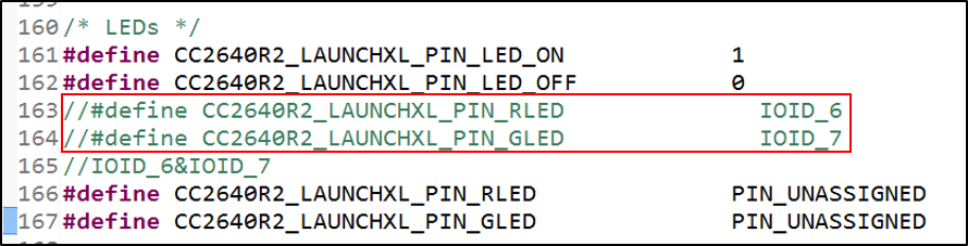

(1) Use the simple_peripheral project in SDK. Firstly , use DIO7 as UART RXD、DIO6 as UART TXD in CC2640R2_LAUNCHXL.h , as picture 3 shows. Then delete the CC2640R2_LAUNCHXL_PIN_RLED and CC2640R2_LAUNCHXL_PIN_GLED, as shown in picture 4.

(2) Delete GPIOCC26XX_DIO_07 and GPIOCC26XX_DIO_06 in CC2640R2_LAUNCHXL.c , as picture 5 shows.

(3) Change the configuration of bootloader backdoor enable controller. Configure SET_CCFG_BL_CONFIG_BL_PIN_NUMBER as DIO23 in ccfg.c , as picture 6 shows .

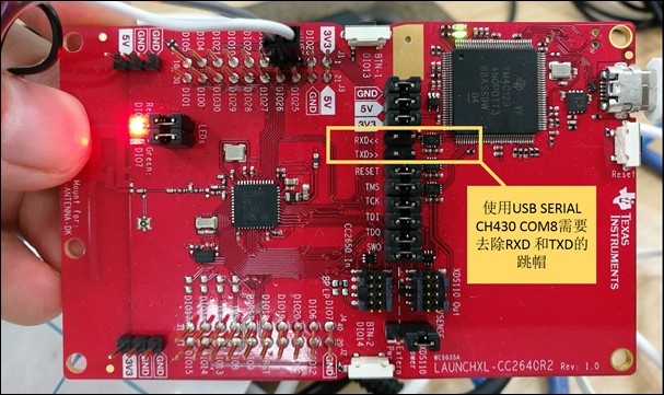

(6) Connect DIO6 and DIO7 of the CC2640R2 launchpad with my computer through USB-TTL, as shown in picture 11 . Disconnect the jumper of TXD and RXD  in CC2640R2 LAUNCHPAD , as shown in picture 12.
picture 11
picture 12
(7) Rebuild the simple_peripheral project and flash it into CC2640R2 LAUNCHPAD . Press the reset button in CC2640R2 LAUNCHPAD while DIO23 in the low level . Then pull up the DIO23 after reset completed . At last , flashing the bin file into CC2640R2 LAUNCHPAD through sblAppEx.exe . However , the CMD window shows CC2640R2 LAUNCHPAD is not in bootloader mode , as picture 13 shows . Where am I wrong ?

  • Hi Heng,
    The ROM bootloader is hard wired to certain DIOs as is documented in the Technical Reference Manual. If you need to interface other DIOs you can consider using a flash implementation of the BL instead. You can find an example here: github.com/.../ble_examples-2.2

  • Thanks for your reply!  Problem has already been solved !
    1、Problem has already been solved
         The reason why the first experiment failed is that DIO2 and DIO3 were not used as UART RXD  and UART TXD.
    2、Detail Analysis
         In 《CC13x0, CC26x0 SimpleLink Wireless MCU Technical Reference Manual》, it has been obviously declared that only DIO2 and DIO3 can be used as UART RXD  and UART TXD ,  reconfiguring is not allowed , as shown in picture 1 .
