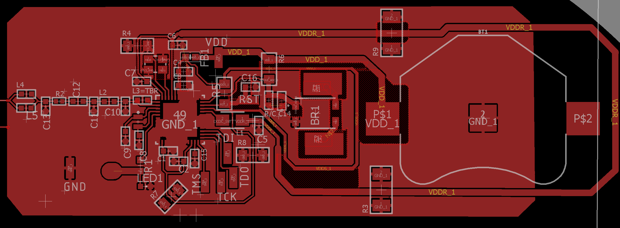

I have designed a custom board, my board design is intended for a single layer PCB so  I have routed all the unused pins to the exposed ground pad, as shown in the attached layout picture. I have measured the current consumption of the board while running the pinstandby example, a current consumption of >16mA is measured while the device is supposed to be in sleep mode. Do I need to have to initialize the pins in a certain way to prevent the current from leaking through the grounded GPIO pins?

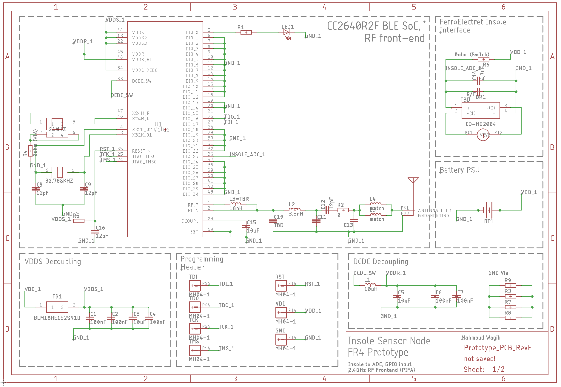

  • I have tested the chip without any programs after erasing the flash and it records a current consumption of 7mA while the launchpad consumes 6mA, when I tried driving one of the shorted pins the current increased by 10mA. I have attached a copy of the schematic, I am currently only driving DIO0 and DIO1
  • Your schematic looks ok, you have added some 0Ohm resistors in places not normally done and I cannot predict the exact performance of doing that (I am speaking of the 0Ohm resistor on the XTAL net). However this is not going to add any current draw.

  • The DCDC layout will not work well. The 10 uF cap must be placed close to the inductor and with a short ground return path to the IC. Can you try to disable the DCDC in CCFG?
    Generally performance will be affected (negatively) by not having good ground connections between decopling caps, RF components, the antenna and the CC2640R2F. I would highly recommend going to a 2-layer design (you seem to have 2 copper layers already) with a solid ground plane on the bottom side.
    For more layout guidance, take a look at the "Design Resources" section of the BLE wiki: ti.com/ble-wiki .

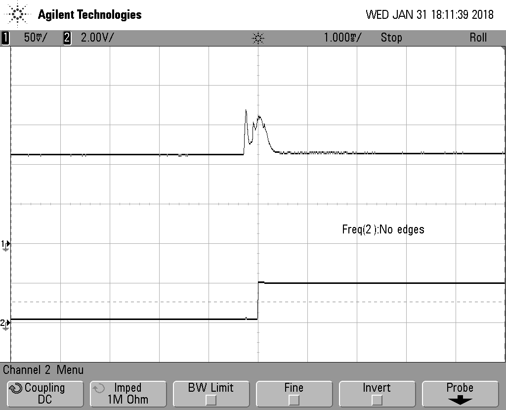

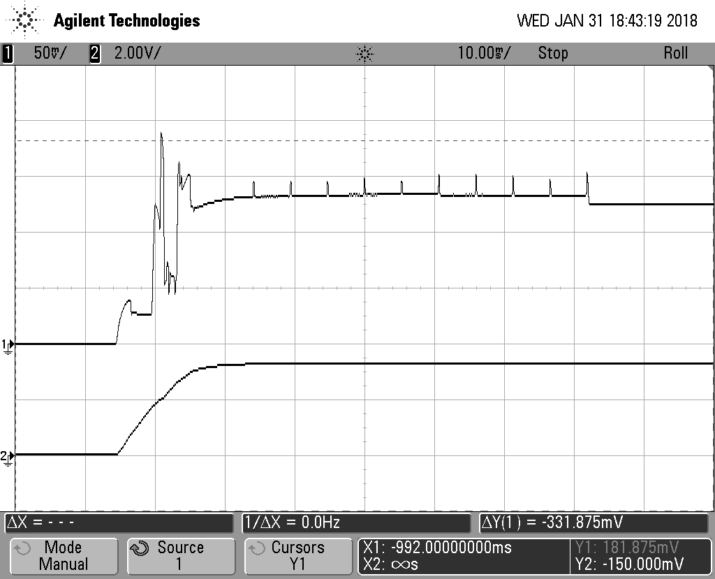

    I supply the board using 1.8V but based on the current consumption the device wasn't starting, I couldn't however ground DCDCSW pin as it's currently hardwired to my VDD. The cc2640r2f only starts at VDD=2.27v, the picture attached shows the voltage across a 10ohm resistor for measuring the current during toggling an LED using the code bellow. However, before running the code on the target from CCS debugger the current drawn is 2mA, opposed to 13mA when the code s running while the LED is off. The startup current is shown in the second picture.
      while(1) {
            /* Sleep, to let the power policy transition the device to standby */
            sleep(standbyDuration);
            /* Read current output value for all pins */
            currentOutputVal =  PIN_getPortOutputValue(hPin);
            /* Toggle the LEDs, configuring all LEDs at once */
            PIN_setPortOutputValue(hPin, ~currentOutputVal);

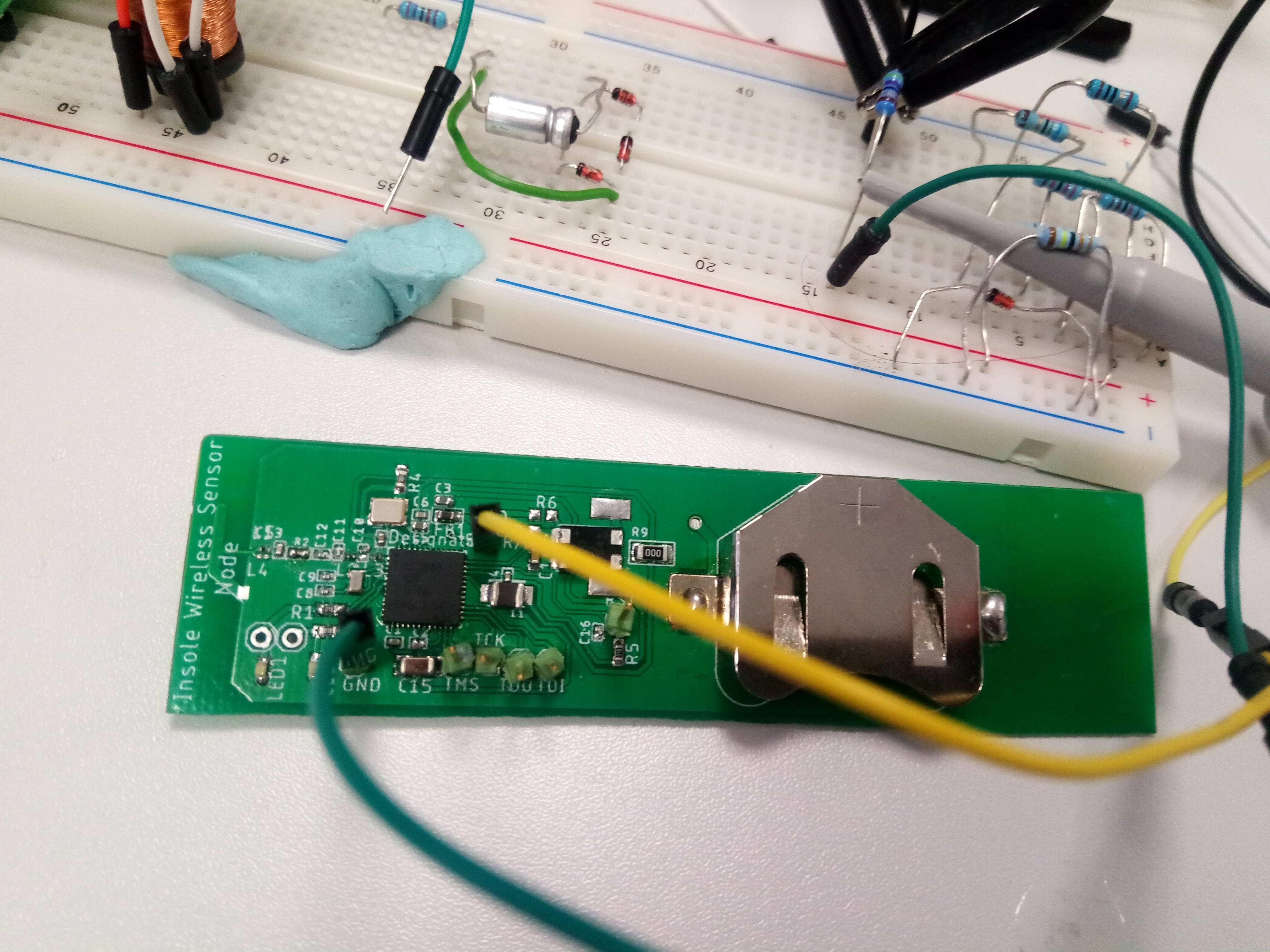

  • Can you post a photo of your board?
  • The VDD terminal is connected to a bench PSU output and the GND is connected to a 10ohm resistor connected to an oscilloscope probe.

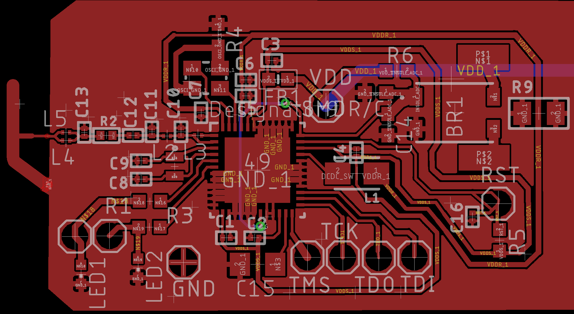

  • Hi Fredrik,
    Would the updated layout bellow fix the problem?
    Thanks for your support
    regards
    Mahmoud
  • Hi Mahmoud,
    I don't think we can know for sure since you have not been able to determine the problem with your original design. The ground connection from C5 to the CC2640 ground pad is also still very poor.
    In general I would also not recommend using jumpers for ground, but rather putting jumpers on other signals to allow the ground plane to pass underneath.
