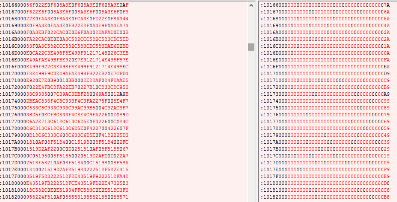

My customer use Flash Programmer to program 20-30 piece CC2541F128.
1. It's successfully at 1st time programming by click "Erase, flash and verify" command.

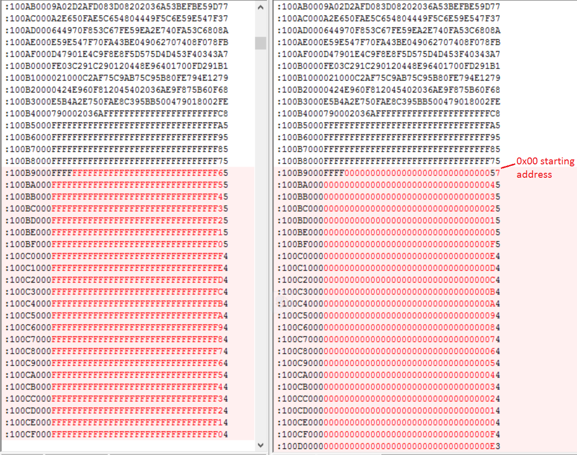

2. Do 2nd programming with another hex, there are 2 piece device report “CC2541 - ID0579: Error in HEX file verification”
3. Do erase, then read out. We find it has many 0x00 rather than 0xFF in some address.
4. Programming by IAR, read out by Flash programmer, it still has many 0x00.
