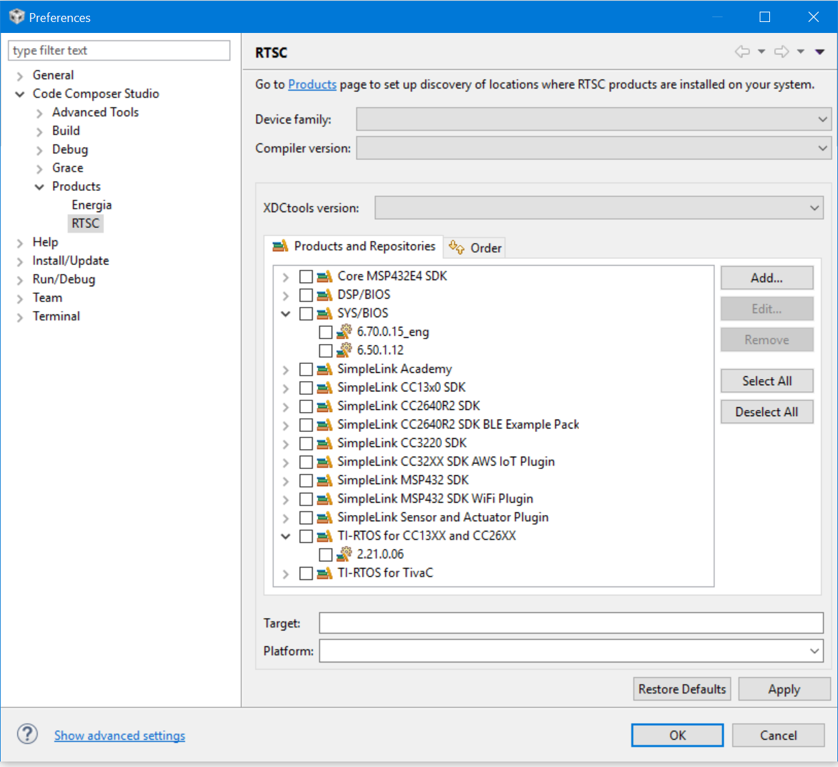

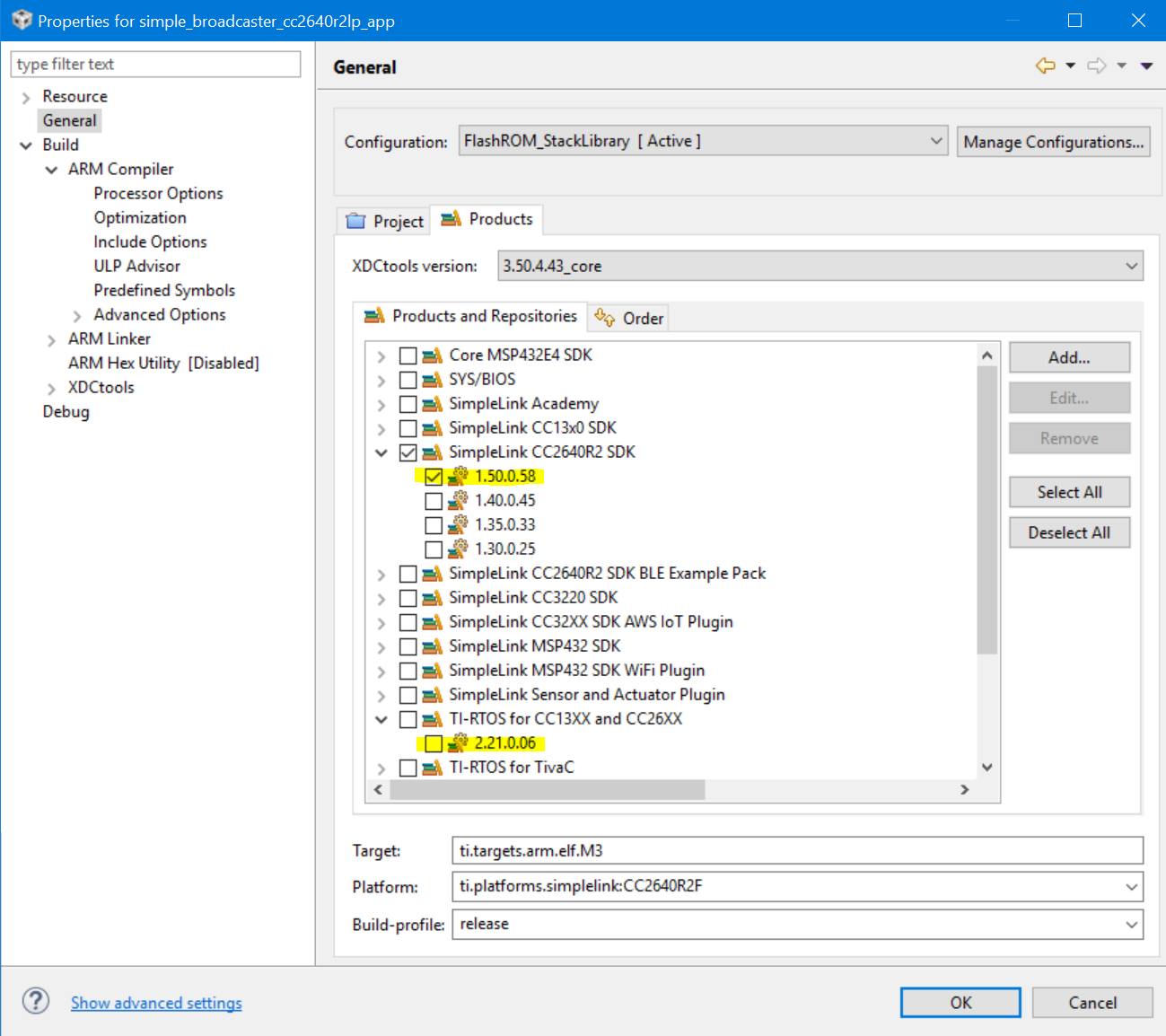

  • You should not have the TI-RTOS product selected along with SimpleLink SDK. They are mutually exclusive.

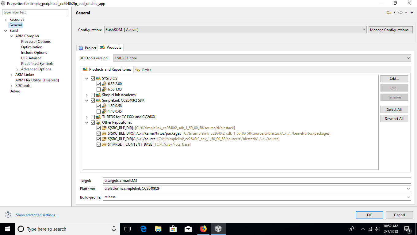

  • Hmmm thats weird i only have the simple_link product selected in that dialog.The Ti-Rtos is unchecked
  •  This is what i have selected
  • 1. Unselect SYS/BIOS. That's include in SimpleLink SDK.
    2. Make sure you don't have anything selected in Window->Preferences->Code Composer Studio->Products->RTSC.
  • Unselected the sys/bios,and un selected all in the rtsc tab still the same thing.This problem doesnt want to let go ha.

  • That's a good news. What happens when you open a config script in XGconf?
    If I understood it correctly, you have multiple config scripts including each other. That might be a problem for XGconf. Can you describe which script is loading other scripts and which one are you loading into XGconf?
  • When i use XGconf i still get the import error as before,Iam not using multiple cfg files iam just compiling the simple_peripheral_oad_on_chip project from tirex.This is all i have int the app_ble.cfg file just the default values in the example.These seem to cause issuse's when i open it with XGconf.
    utils.importFile("common/cc26xx/kernel/cc2640/config/cc2640_r2_csdk.cfg");
    utils.importFile("common/cc26xx/kernel/cc2640/config/ble_stack_heap.cfg");
  • I have replicated your problem and I can see that XGconf for some reason uses a different package path than what's used in the app build. Your best bet is to edit app_ble.cfg and use the absolute path for these two script:
    utils.importFile("C:/ti/simplelink_cc2640r2_sdk_1_50_00_58/source/ti/blestack/common/cc26xx/kernel/cc2640/config/cc2640_r2_csdk.cfg");
    utils.importFile("C:/ti/simplelink_cc2640r2_sdk_1_50_00_58/source/ti/blestack/common/cc26xx/kernel/cc2640/config/ble_stack_heap.cfg");
    This means you won't be able to move your project to a different PC without changing these two lines, but there is no a better workaround right now.
    In the meantime, I'll try to find the cause of the different path in XGconf, but I can't tell how long it will take.
  • This solved the issue,just a side note for anyone else you have to change both paths the ble_stack_heap.cfg,and cc2640_r2_csdk.cfg.I did this before but only changed the cc2640_r2_csdk.cfg which caused a error "Description Resource Path Location Type
    xdc.services.intern.xsr.Value$Obj@146efbb::xdc.runtime.Error is not a function, it is object".
    So i didnt bother to change the ble_stack_heap.cfg since there was a error oops oh well.Thanks for all the help
