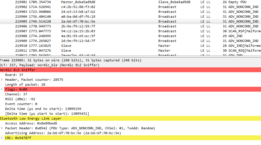

  • full_log.zipHi,
    Its a random behaviour. some times within 30 mins some times more than 4 hours.
    Every 2sec we are connecting and disconnecting the BLE.
    Here i am attaching sniffer log. . we gave the disconnect from central. But its not received to our Application . The end of the log is during this issue. After this no advertisement and also Application timers also not triggering. from the log end it shoes some non connectable adv and error.
    Please analyze the log and Update that what went wrong. Also how can we recover the system in case if this issue happenes.

    At the time of the lock up is are there any heap allocation failures (note I asked this before, but specifically I want to be sure that you have measured at the time of the failure). Are there any other failures observed when scanning the ROV. What is the state of the GAP Role Task, what is its callstacks. Has an exception or abort occurred?
    You mention that your clock is not firing, can you determine if SWIs are disabled at this time?
    No heap failure at the moment. GapRole state is connected . No exception or abort.
    yes. SWIs are enabled at this time. but one query here is even ifs disabled also when enabling the SWI the clock should trigger the interrupt. Am i right?
    One more thing is basically the system is not crashed . background my application is running. because of that watchdog is running and no reset.
    only during that time GAPROLE_WAITING event not reached to application. the same time the application supervision timer is also not expired.
    During that time if you see the log the device giving NON_CONNECTABLE Advertising suddenly.
    you can have the better understanding what could make the system to give NON_CONNECTABLE Advertising suddenly.
    may be this info will be helpful for your support

  • Hi Thangaraj,
    As discussed, the capture shows that the ADV_NONCONN_IND are coming from a device with a different address type, specifically a Random address (private)  which is not the device that you are using, (public address). See screencap below
    The best case would be to run the heap manager metrics (HEAPMGR_METRICS) on the connect/disconnect test bed and observer the heapmgrMemFail variable at the time of failure. If you wish to assert during a heap failure you can also use MEM_ALLOC_ASSERT (note this required a HAL Assert handler to be plugged).
    Additionally, it would be helpful to consider porting the test to TI LaunchPads. If it can be reproduced in this form, we can easily aide in debugging.
