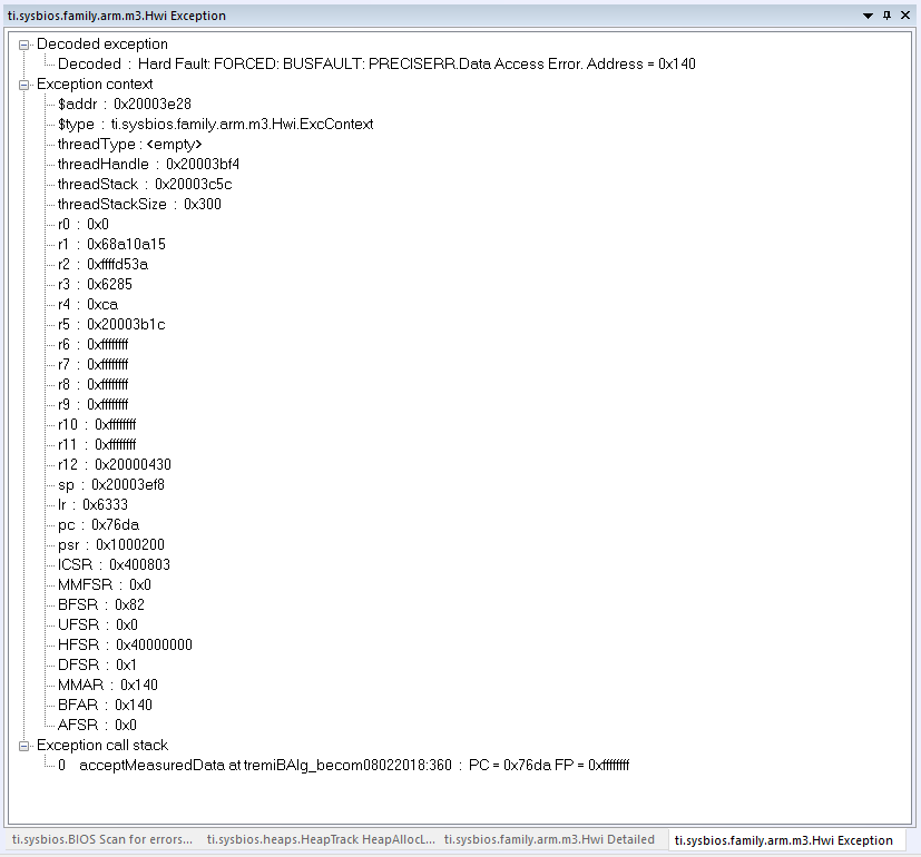

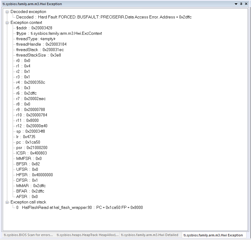

Now the problem is that the processor hangs up, when long push action #3 (only happens in this mode) was successfully processed and pending again on button events in next loop iteration.
When the button is pushed at this stage one of the following is happening,
-)  Processor hangs up - disassambly:
-) IAR hungs up without error message
-) IAR hungs up with following error message:
I also tested our battery powered device "Standalone". Short push mode #1 is working fine, but once long push mode #3 occured cpu hangs up as well at next iteration.
What could cause the hang up of the CPU?
