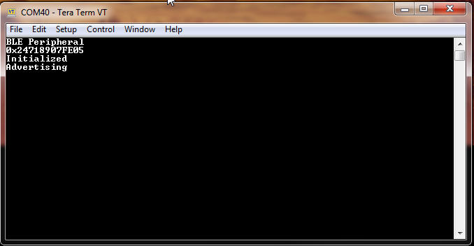

  • You should have a similar output to this:

  • I found the problem:
    In SimpleBLEPeripheral_init() the device is HARDCODED:
       dispHandle = Display_open(Display_Type_LCD, NULL);
    this has to be changed to:
      dispHandle = Display_open(Display_Type_UART, NULL);
    It really sucks that on one hand they over design and abstract the hell out of embedded code because people don't want to have to understand whats going on under the hood; and on the other they do crap like this.
