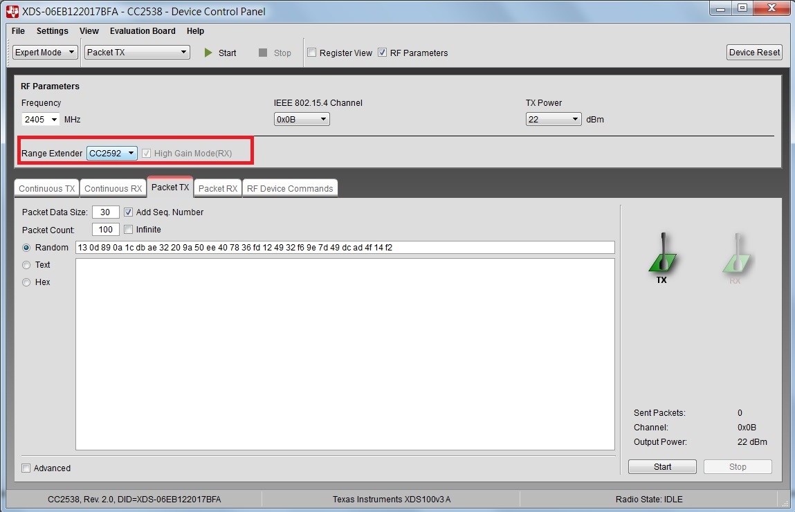

Hi, I've developed a zigbee module based on the CC2538-CC2592EM reference design, and am using the TI eval modules  to get some benchmark perfromance figures. During testing I have found that the TI reference boards have very low receive signal strength.
Test setup.
- Zigbee coordinator approx 2m away, sending constant NWK messages
- CC2538-CC2592EMK board attached to a XDS1200v3 through the cJTAG pins, and running SmartRF Receive Packet test. CC2592 range extender is enabled, and set to high gain mode
- Zigbee sniffer on laptop, within 50cms of CC2538-CC2592EMK. The sniffer is the CC2531 USB device.
I've attached log of results from Smart RF packet receive. It shows that the receive RSSI is very low, around -70dBm to -80dBm, with occassional packet loss, however the sniffer, which is close by, shows consistent receive values of around -40dBm. This is not what I expected. Is there something in the setup that's missing?

  • I suggest you to use SmartRF Studio 7 to do TX/RX test first to verify your design.
  • Please read the original post. I am not using my custom board, I AM using the TI CC2538-CC2592EMK board, and I'm using SmartRF 7 rx packet tests. The TI board has very low recieved signal strength, around -70 to -80 dBm with trasnmistter only 2m away.
  • Do you select Range Extender to CC2592 in SmartRF Studio 7 when you do the test?
  • Yes, as I stated in the original post. I have enabled the CC2592 and set high gain mode in Smart RF

  • I do similar test with my CC2538-CC2592EMK and CC2531EMK-USB. The followings are my results

  • This is what I would expect. So is there any particular calibration or setup required on the CC2538, or do I have faulty boards. I've tried both boards in the kit and get same result. Just to review my setup, I have an XDS100v3 debugger connected to a TI CC2538-CC2592EM board using the cJTAG pins (Vtarget, TMS, TCLK and GND). The CC2538-CC2592EM is powered by 5V USB, and I've bridged the 3V supply to the cJTAG Vtarget connection. Smart RF finds the device ok and I can run the tests ok. I also have the CC2531 USB sniffer.
  • No particular calibration or setup required as I know. Can you take a picture of your CC2538-CC2592EM board and attach it?
  • Are you using the SmartRF06EB? Does this do anything differently that is not happening when I just use the cJTAG connection?
  • Yes, I use SmartRF06EB. I don't think it would act differently to use cJTAG connection. However, you can try SmartRF06EB to verify it.

  • Hi YK, Would you please post a copy of your register settings in SmartRF, for the test setup you did earlier. I'm not expecting anything to be different to my settings but want to make sure. This issue is a real problem for me as this project is now behind schedule and waiting till this is resolved.

  • NameAddressValueDescription
    FRMCTRL1 0x40088628 0x00 Frame handling
    FREQCTRL 0x4008863C 0x15 Controls the RF frequency
    TXPOWER 0x40088640 0xFF Controls the output power
    FSCAL1 0x400886B8 0x01 Tune frequency calibration
    AGCCTRL1 0x400886C8 0x15 AGC reference level
    TXFILTCFG 0x400887E8 0x09 TX filter configuration
    IVCTRL 0x400D6004 0x0B Analog control register
    GPIO_C_DATA 0x400DB3FC 0x08
    GPIO_C_DIR 0x400DB400 0x0C
    GPIO_D_DIR 0x400DC400 0x04
  • My FRMCTRL1 value was 0x01, changed to 0x00 but made no difference. I also have a lot of other registers that show up in the window but I assume you didn't send all because they're not relevant.
