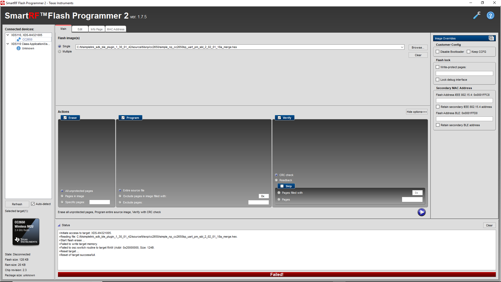

I am getting an error (see attached) when I try to program a hex file into the CC2650 module using SmartRF Flash Programmer 2 version 1.7.5 software.
What am I missing?

  • Try to do a mass erase and download again.
    I tried to do the CC26xx/CC13xx Forced Mass Erase. I am still unsuccessful. I am now getting this error message:

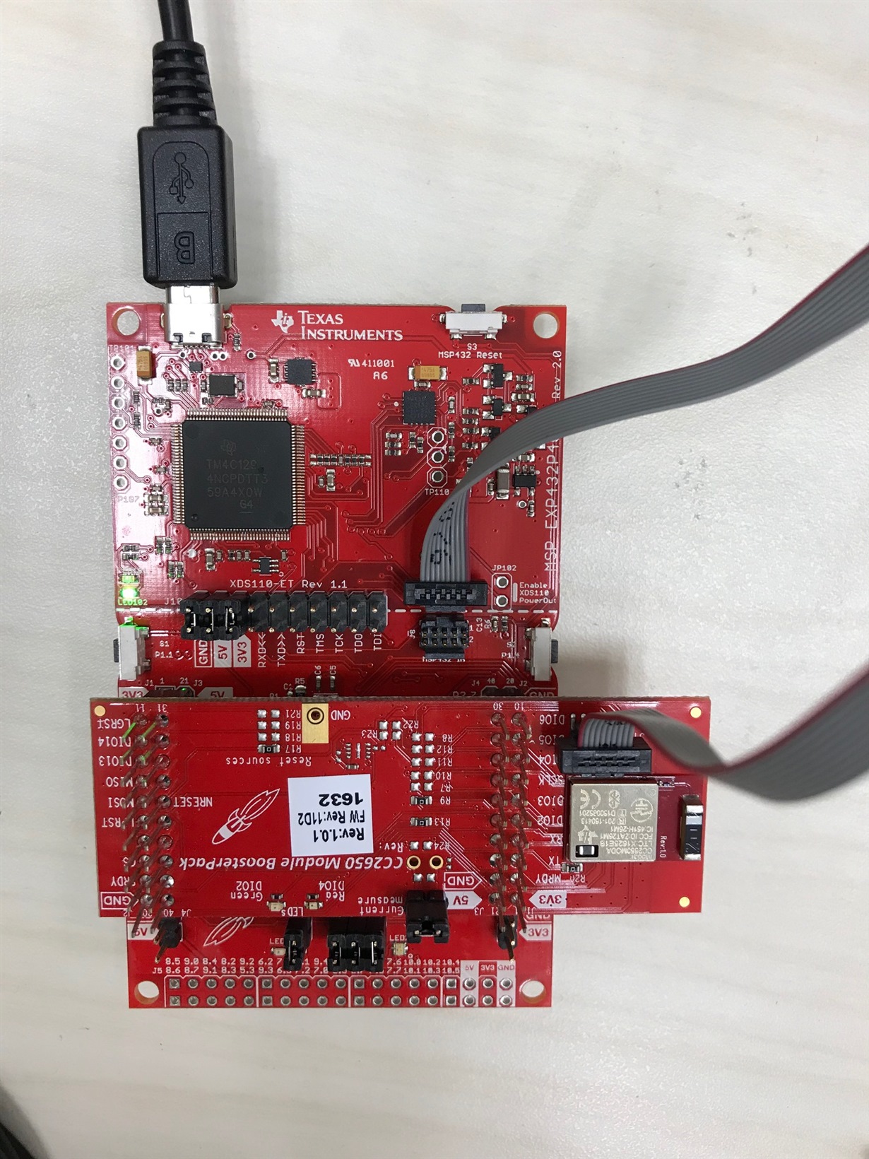

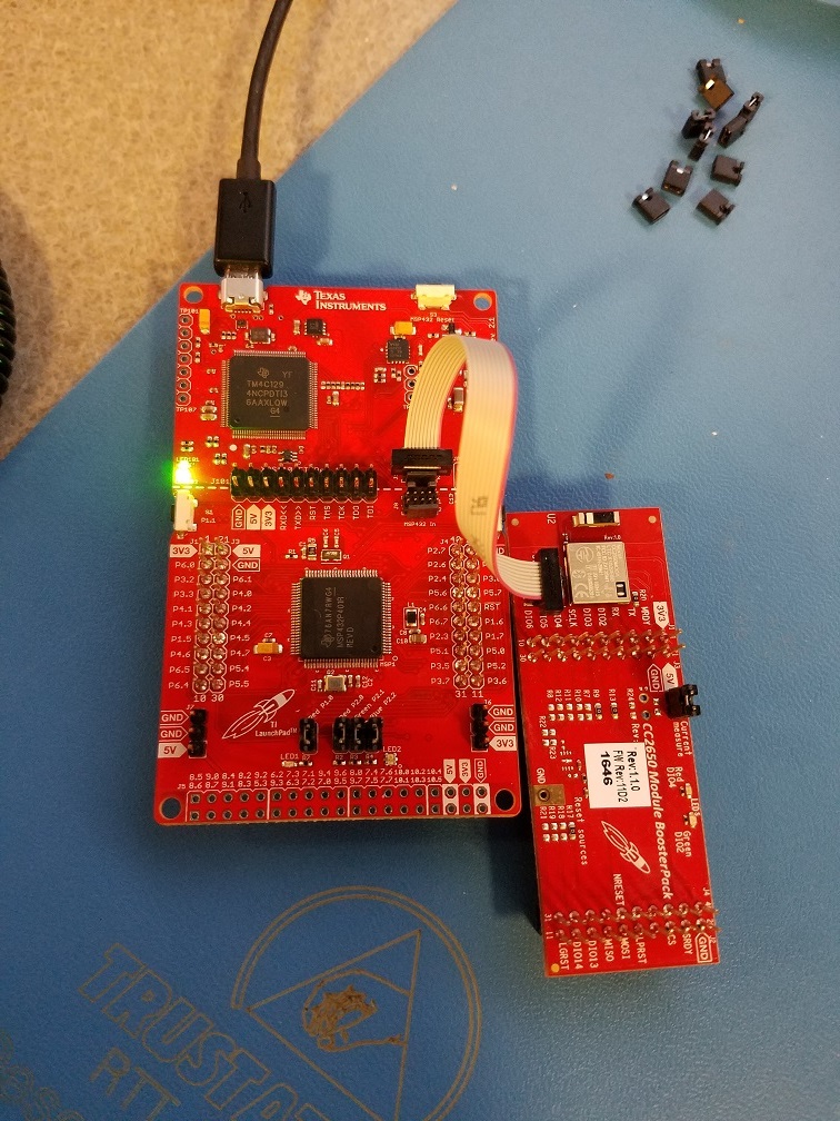

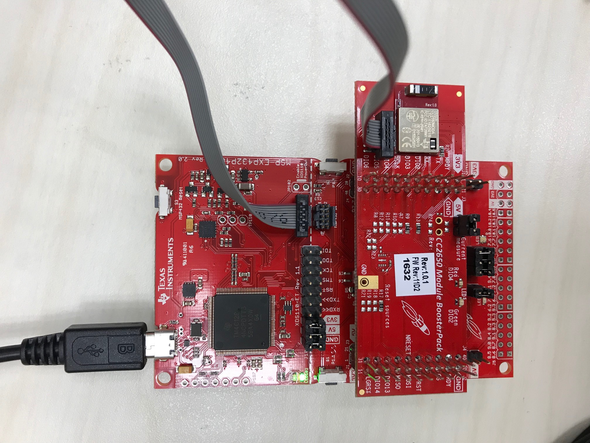

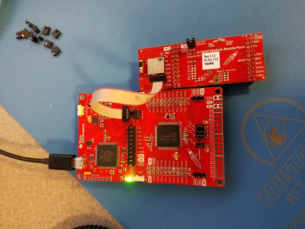

    Attached is a picture of my board connection.

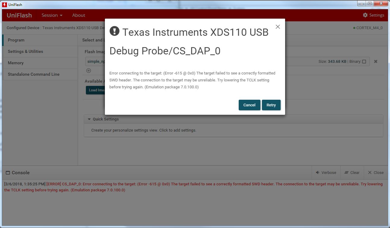

    I have also tried to use UniFlash version 4.2.2.1692. I am getting this error message in UniFlash.
    I have already tried on 3 different BOOSTXL-CC2650MA and MSP-EXP432P401R board sets. I am getting the same results.

  • When I test this, I mount GND, 5V, and 3V3 jumpers between XDS110 and MSP432 on LaunchPad and I also mount BOOSTXL-CC2650MA to MSP432 LanunchPad to program it. You can try the same thing to see if it works.
  • Thanks! It works now. The following documents need to be updated:
